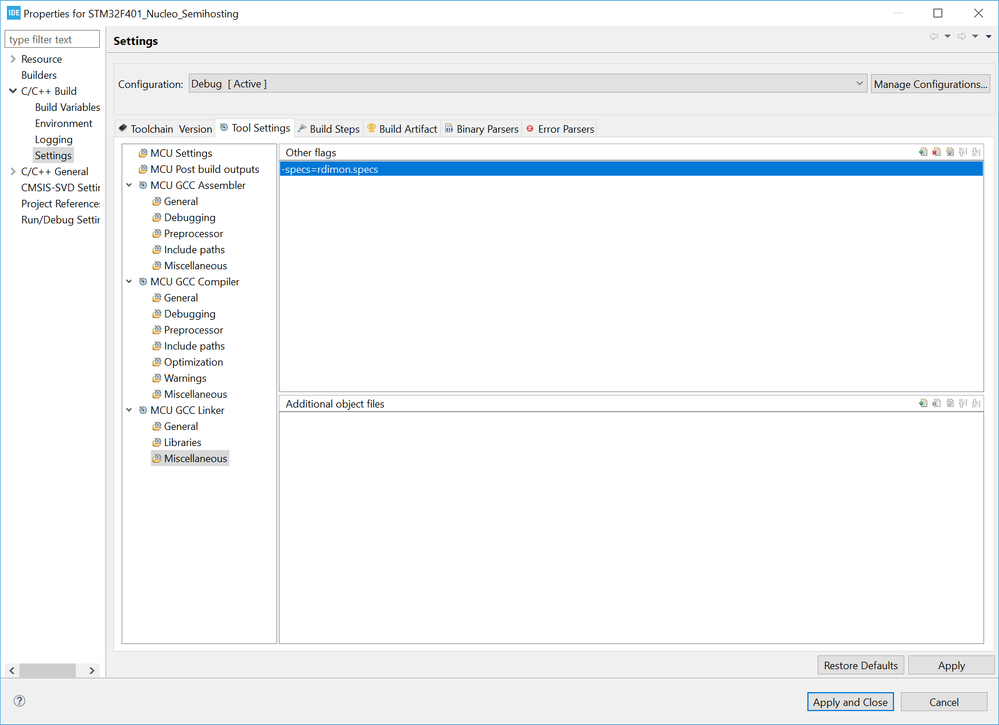

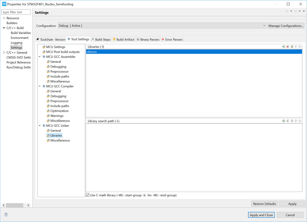

2.3. Update GCC Linker configuration
In Libraries add “rdimon” library.
In Miscellaneous add Other flags “-specs=rdimon.specs”

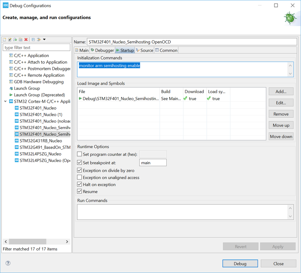

3.1. Create/Update OpenOCD debug configuration
Create a new debug configuration for the project or update an existing one. Make sure that OpenOCD is used.
Note: ST-LINK GDB server does not support semihosting.
Add “monitor arm semihosting enable” initialization command in Debug Configurations - Startup tab.

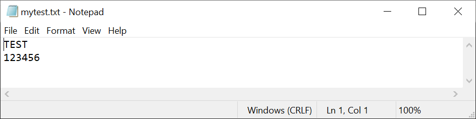

Stop the debug session to analyze the log file.
4. Analyze debug session
The program opens and writes to the file c:\dev\mytest.txt. Open the <mytest.txt> file and information from the debug session can be seen.
