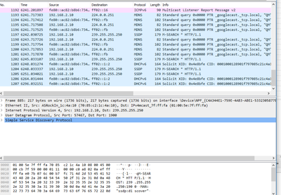

@Adam BERLINGER - hey thanks for the article.
is it possible to provide a simple LWIP project without FREERTOS with the latest CubeMX (6.9.2)?
I can't find an LWIP project only for STM32H743 with the latest CubeMX... tried to generate one myself with google example but the LWIP UDP not working.
see Wireshark:
pls help, I really want to use the most updated CubeMX.
thanks
