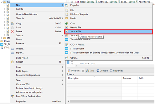

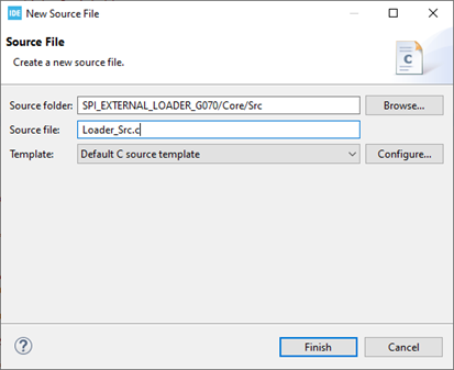

First, create the file that will receive all the necessary External Loader functions. In Core -> Src click with right mouse button, go to New -> Source File and create a file named “Loader_Src.c”.
This file needs to receive the following functions in these specific format (the same names, types, parameters and return values). These functions will be used by STM32CubeProgrammer to manage the external memory and you should place your memory driver inside that, according to the function purpose. These are the functions will need to populate:

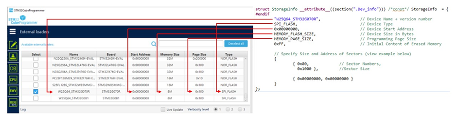

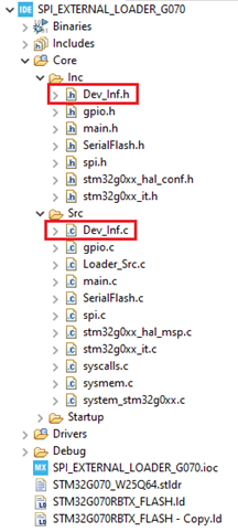

int Init(void) { SystemInit(); SCB->VTOR = 0x20000000 | 0x200; HAL_DeInit(); HAL_Init(); /* Configure the system clock */ SystemClock_Config(); /* Initialize all configured peripherals */ MX_GPIO_Init(); MX_SPI2_Init(); __set_PRIMASK(0); //enable interrupts W25qxx_Init(); //External memory function initialization __set_PRIMASK(1); //disable interrupts return LOADER_OK; }The other two files that we need to create are “Dev_Info.c” and “Dev_Info.h”. These files will manage the header memory information used by STM32CubeProgrammer to read, program and erase the device – there are examples available in the STM32CubeProgrammer installation folder and also referred in the UM2237. So, let’s start creating these files from scratch. Create “Dev_Inf.h” in Core - > Inc folder, and “Dev_Inf.c” in Core -> Src.
#define MCU_FLASH 1 #define NAND_FLASH 2 #define NOR_FLASH 3 #define SRAM 4 #define PSRAM 5 #define PC_CARD 6 #define SPI_FLASH 7 #define I2C_FLASH 8 #define SDRAM 9 #define I2C_EEPROM 10 #define SECTOR_NUM 10 // Max Number of Sector types struct DeviceSectors { unsigned long SectorNum; // Number of Sectors unsigned long SectorSize; // Sector Size in Bytes }; struct StorageInfo { char DeviceName[100]; // Device Name and Description unsigned short DeviceType; // Device Type: ONCHIP, EXT8BIT, EXT16BIT, ... unsigned long DeviceStartAddress; // Default Device Start Address unsigned long DeviceSize; // Total Size of Device unsigned long PageSize; // Programming Page Size unsigned char EraseValue; // Content of Erased Memory struct DeviceSectors sectors[SECTOR_NUM]; };In “Dev_Inf.c” we only need to declare and initialize that struct and store it on the .Dev_info section of the RAM (for that, an __attribute__(section(“.Dev_Info”)) is placed in the struct declaration). The variable data of the struct should be changed to be compatible with the memory.
/* * Dev_Inf.c * */ #include "Dev_Inf.h" /* This structure contains information used by ST-LINK Utility to program and erase the device */ #if defined (__ICCARM__) __root struct StorageInfo const StorageInfo = { #else struct StorageInfo __attribute__((section(".Dev_info"))) /*const*/ StorageInfo = { #endif "W25Q64_STM32G070R", // Device Name + version number SPI_FLASH, // Device Type 0x00000000, // Device Start Address MEMORY_FLASH_SIZE, // Device Size in Bytes MEMORY_PAGE_SIZE, // Programming Page Size 0xFF, // Initial Content of Erased Memory // Specify Size and Address of Sectors (view example below) { { 0x80, // Sector Numbers, 0x1000 }, //Sector Size { 0x00000000, 0x00000000 } } };The struct data is shown by Cube Programmer when the External Loader is present on that.

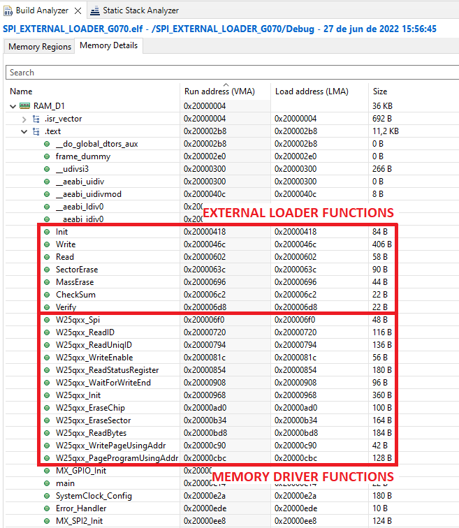

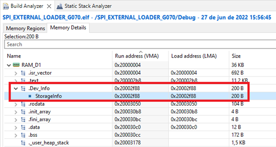

Building the project, the functions (including the memory driver functions) should be inside the .text section that are in the RAM_D1 memory area and a section named .Dev_Info with the StorageInfo struct was created.

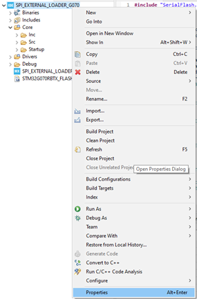

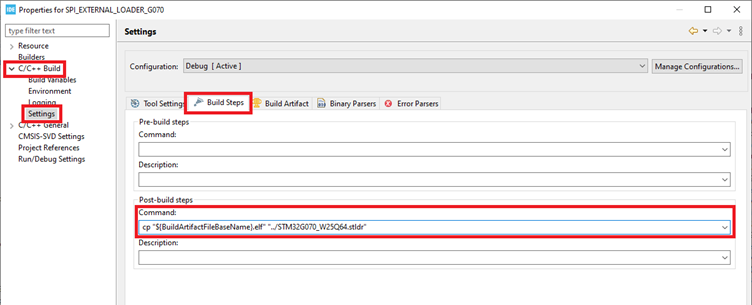

In the settings, go to C/C++ Build -> Build Steps and add the following text in Command text box of Post-build steps:

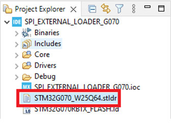

cp "${BuildArtifactFileBaseName}.elf" "../STM32G070_W25Q64.stldr"

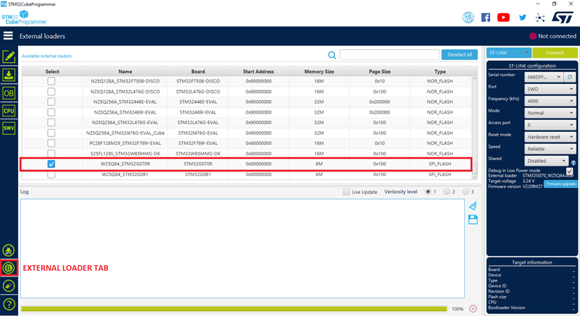

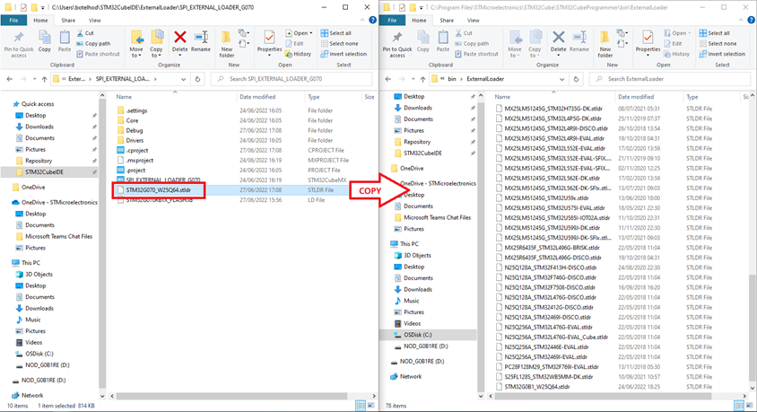

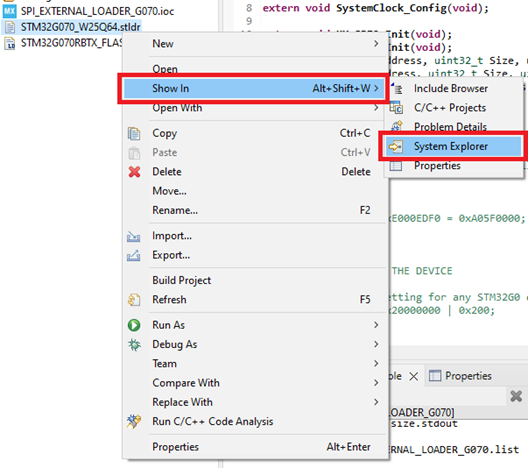

Now, the driver is ready to be used and we need to import that in the STM32CubeProgrammer. Copy the STM32G070_W25Q64.stldr file (that’s located in the root project folder) to the External Loader folder of the STM32CubeProgrammer. A fast way to locate this file is clicking with right mouse button on that and going to Show In -> System Explorer, so the file explorer should be open in the file located folder.
Then, copy and paste the *.stldr file to External Loader folder of the STM32CubeProgrammer, located in:
“C:\Program Files\STMicroelectronics\STM32Cube\STM32CubeProgrammer\bin\ExternalLoader”(this path can change depending of your installation path, another way to reach on that is clicking with right mouse button on the STM32CubeProgrammer desktop shortcut and going to “Open file location” and search for the ExternalLoader folder on the opened location).

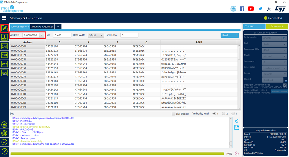

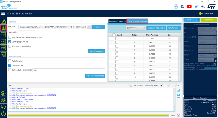

Going back to “Memory & File edition” and searching for an address of the external memory, if the process done well, you will see the content stored on that. In this case there are a sequence stored on the memory that starts from the 0x00000000 address.
If all the steps were properly made, the External Loader is running properly and now you can directly read, program and erase external memories. Congratulations!
