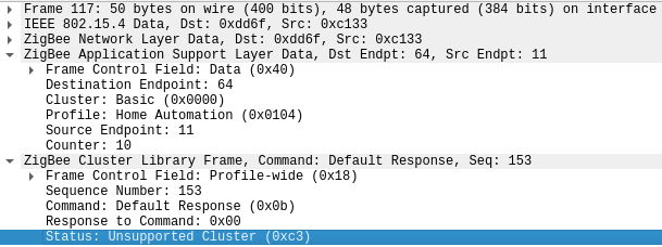

I am working with the STM32WB55 Nucleo board to create a Zigbee device being able to connect to a Philips Hue Bridge v2.1. Using a 2.4GHz sniffer with wireshark I am able to follow the communication which goes through the following steps with no problems:
- Beacon
- Association request + response
- Transport key exchange
- Node descriptor request + response
- Endpoint descriptor request + response
- Simple descriptor + response

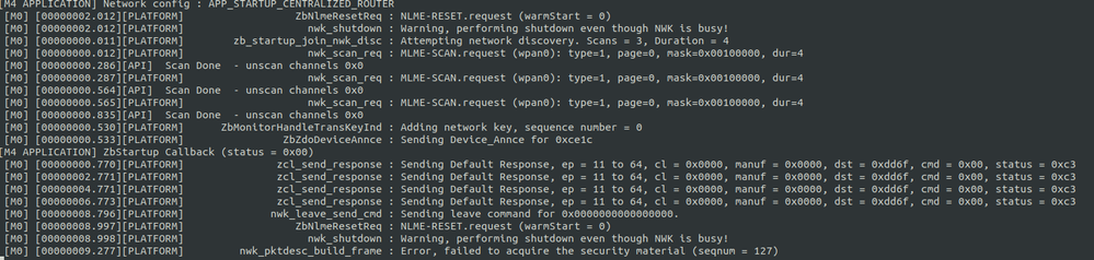

Where it fails is the coordinator (hue bridge) sends a Read attributes on the Basic cluster (0x0000) to the STM32. It responds with a ZCL Default response where status says "unsupported cluster (0xc3)".
And the trace output from the STM32WB55 reports that it sends this default response, but I would expect it to be responding with the Basic attributes configured.

I'm reusing this thread, as I encounter similar problems.
- Without initialization, the Basic cluster contains "ST" values.
- I'm able to update the Basic cluster attributes with ZbZclBasicWriteDirect, once the endpoints are created. Values are shown correctly over the Zigbee network.
- With the same structure, before the endpoints creation, the ZbZclBasicServerConfigDefaults function change the values, but they are not displayed correctly (for example "TE<?><?>" instead of "TEST1").
It seems there are some bad memory copies, but the structure used is the same in both 2) or 3) cases.
Any idea ?
