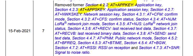

As per the application note AN4967 Rev 7 AT+APPKEY command has been removed from the firmware of AT_SLAVE. I would like to know how can i set or enquire the APPKEY via AT Commands. Also is there possibility to set this key in firmware itself?
Since as per the lora standard for OTAA activation, user should setup APPEUI, DEVEUI and APPKEY. But since command for AppKey removed so i wonder how can i set this key on module.
Please update and share if there is any good reason to remove or the way to set the key in firmware itself.

Effectively this AT_SLAVE command has been removed by mistake from this I-CUBE-LRWAN version, and our team is currently working to fix this and reintroduced this command in the next release.
So, please keep an eye out for the coming update.
For the time being and to overcome the problem, you have to modify the commissioning of your device by the way of the “se-identity.h�?.
Please see below and extract of this file where we see the APPKEY definition

* When set to 1 DevEui is LORAWAN_DEVICE_EUI
* When set to 0 DevEui is automatically set with a value provided by MCU platform
#define STATIC_DEVICE_EUI                                  0
* end-device IEEE EUI (big endian)
#define LORAWAN_DEVICE_EUI                                 { 0x00, 0x80, 0xE1, 0x01, 0x01, 0x01, 0x01, 0x01 }
* App/Join server IEEE EUI (big endian)
#define LORAWAN_JOIN_EUI                                   { 0x01, 0x01, 0x01, 0x01, 0x01, 0x01, 0x01, 0x01 }
* When set to 1 DevAddr is LORAWAN_DEVICE_ADDRESS
* When set to 0 DevAddr is automatically set with a value provided by a pseudo
*      random generator seeded with a value provided by the MCU platform
#define STATIC_DEVICE_ADDRESS                              0
* Device address on the network (big endian)
#define LORAWAN_DEVICE_ADDRESS                             ( uint32_t )0x0100000A
* Application root key
#define LORAWAN_APP_KEY                             2B,7E,15,16,28,AE,D2,A6,AB,F7,15,88,09,CF,4F,3C   --> to be modified. Afterwhat regenerate the AT_SLAVE application
* Network root key
#define LORAWAN_NWK_KEY                                    2B,7E,15,16,28,AE,D2,A6,AB,F7,15,88,09,CF,4F,3C

Hi @Imen DAHMEN​ Thanks for you response, will try the suggested solution and update. This may be useful for others as well.
Loïc
Any news concerning this issue ? Is there a new release already ?
EDIT : I see now in the document's revision a new revision that updated AT Commands. (5.10.2021) . Thanks for the patch, will try it
