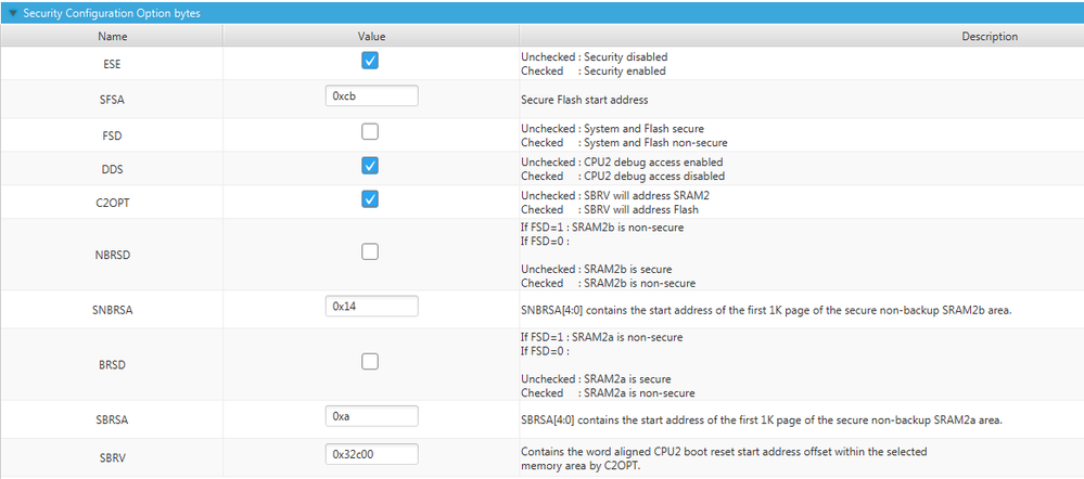

And here are the option bytes, I assume these are default values.
Remi QUINTIN
​In fact I would like to see the secure option bytes: ESE, SFSA, SBRV, C2OPT, ...

Remi QUINTIN
They look good. At least the SFSA is set at a level that can let us confirm that the RF stack is correctly installed. Are you using the new CubeProgrammer V2.2 with the SWD protocol?

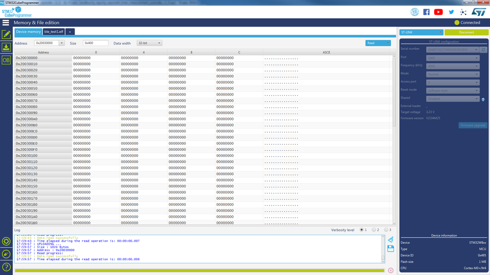

Do you see some data existing  in SRAM2a  starting from 0x2003 0000 (IPCC data buffers)?
MLeng.638
@Remi QUINTIN​
Updated the CubeProgrammer to v2.2, but everíthing is the same.
From the addres 0x2003 0000, I only see a bunch of zeros, like this:0690X00000AqsodQAB.png
Remi QUINTIN
​Clearly the RF stacks is not working.
The fact that you do not see any data, especially on 0x20030030 shows that the FUS is not activated.
One way to do it is to perform a fw delete  . This will trigger the FUS and one of its first action is to write its version at 0x20030030.
·        FUS FW delete :
        STM32_Programmer_CLI.exe -c port=swd -fwdelete
·        Read FUS version :
        STM32_Programmer_CLI.exe -c port=swd -r32 0x20030030 1
Then if the 2 commands above are successful with a FUS version not being 0, you should be able to upgrade the FUS if the version is V0.5.3 (=0x00050003). If it is not ,for example if the version number is V1.0.2 (0x=01000200), then you don't have to update it. It is the most recent as of today.

MLeng.638
@Remi QUINTIN​
The -fwdelete was succesful with the new CubeProgrammer, Thanks, but sadly still get 0s from the second command:
