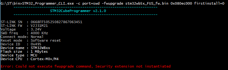

I'm trying to flash the FUS and BLE_stack to the co-processor, but the CubeProgrammer drops me the error below. I could not even delete the previous FUS as the release note said. Same error message. The flash was erased by changing the protection byte to 0xBB and then back to 0xAA. Could that be my problem? The MCU is on a custom PCB, and the important parts are the same as on the WB55-Nucleo and I'm using a nucleo with s-link to program through SWD. The application runs perfectly on the M4 (except the bluetooth part).
So the error message is: "Error: Could not execute fwupgrade command, Security extension not instantiated".

​>The flash was erased by changing the protection byte to 0xBB and then back to 0xAA.
No this just erases the non -secure part of the Flash memory.
The issue is more on the SWD side. This interface does not support the upgrade process of the secure part completely. For example the upgrade commands are not supported. They will be supported in the next version of the FUS operator that should available very soon (a few weeks).
So for now we recommend to use either the UART or the USB-DFU interface.
The next version of the upgrade tool using the Debug (STLINK/SWD) Interface  will support the full upgrade process even with one single command.
