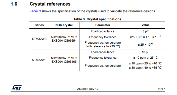

We have a design implementing the STM32WL55/WE5.
The recommended crystals on the reference designs and literature are:
NX2012SA 32.768KHz EXS00A-MU00527X2
NX2016SA 32MHz EXS00A-CS06465
I want to verify that it is OK to use the following:
For NX2016SA:  EIIECS-320-10-37B-CKY-TR
CRYSTAL 32.0000MHZ 10PF SMD ESR 50 ±10ppm ±10ppm -30 ~ 85 2.0x1.6x0.45mm
For NT2016SF-32M-END5875A:  EIIECS-TXO-20CSMV-320-EY-TR
MultiVoltTCXO,32MHz,±2.5ppm,1.7V~3.465V,2.5mA,-30°C~85°C,ClippedSineWave
The design must comply with SigFox and LoRa spec and will potentially be in field for a long time (10+ years).
Datasheets attached.

Hello @DRoss.3​ and welcome to the Community :)
For information about crystal compatibility with STM32WLSeries, please refer to the AN5042 and
Table 7. Recommended crystal / MEMS resonators for the LSE oscillator in STM32 products (in AN2867)
