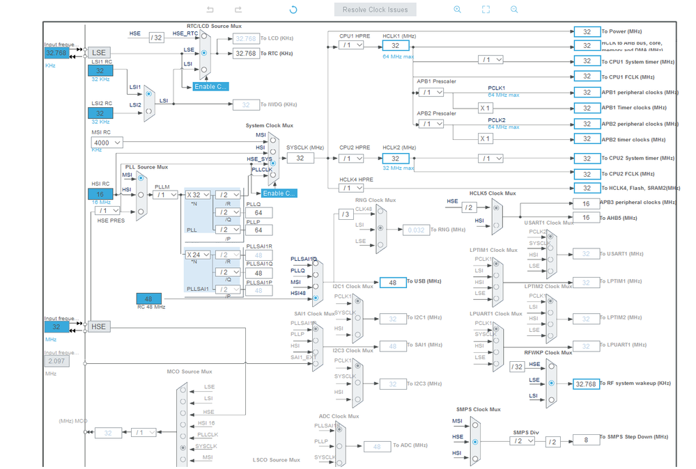

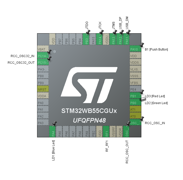

Hello, everybody! I faced with some problem. If I init USB_Device as CDC by STM32CubeMX then OS detect dongle as "Unknow Device", but if I use ready project from STM32Cube_FW_WB_V1.3.0 (BLE_TransparentModeVCP) then Dongle is working.
What reasons of this behaivor?
USB settings in thu Cube on the pictures

Thank's for answer. Windows 10 shows error code 43.
This error means hardware problem, but there is not hardware problem because dongle work correctly with standard program.
Cube initialize USD_Device in the Main function. Is it enough for determinate dongle by OS?
