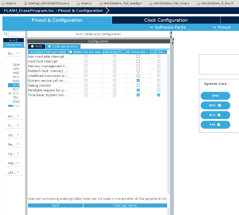

‎2022-08-04 6:56 AM

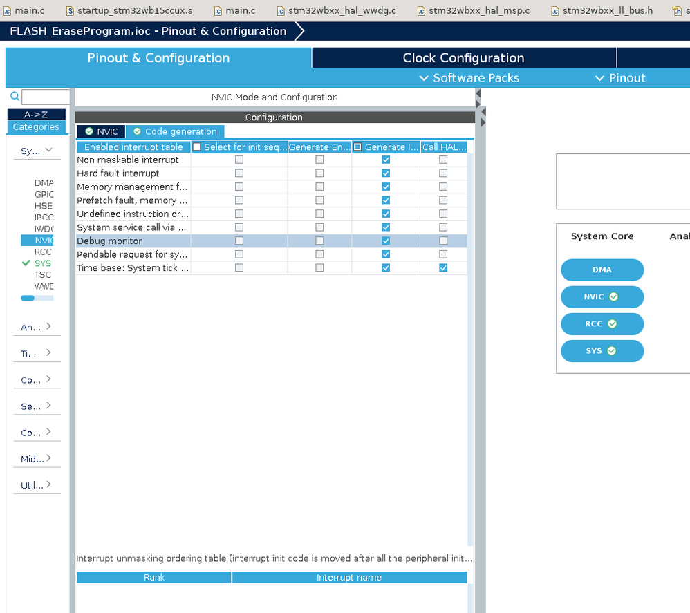

Investigating further I found a difference of FLASH_EraseProgram to WWDG_Example in the NVIC settings. I added "Generate IRQ handler" accordingly and now the program ends in the HardFault_Handler instead of the Default-handler:

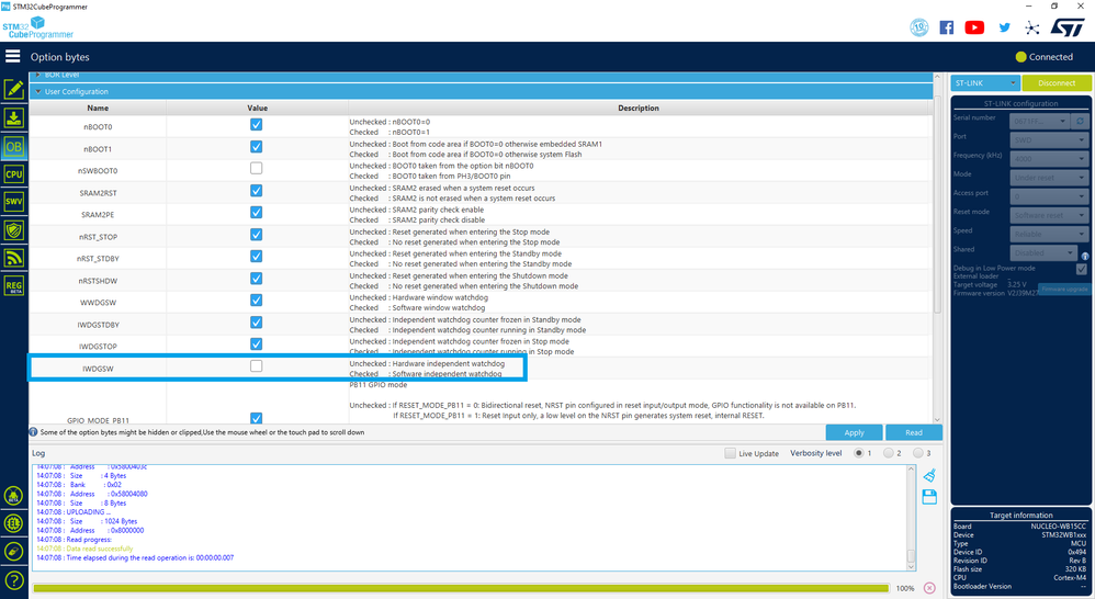

Hello @VSaro.1​
First thanks for posting.
In this case I recommend that you check the user configuration under the Option Bytes for your SOC with CubeProgrammer.
Specifically the IDWGSW it should be Unchecked.
Kind regards,
Semer.
‎2022-08-29 8:07 AM
Thanks Semer, it seems to work now.
Kind regards
Volker
‎2022-08-29 8:46 AM
Hello Semer,
ok, after unchecking IDWGSW it doesn't end in the WWDG_IRQHandler() but...
the program never returns from the call to HAL_FLASHEx_Erase(&EraseInitStruct, &PageError), see line 145 in FLASH_EraseProgram/Src/main.c.
