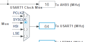

@Nour wrote:I used an oscilloscope and I've found 1428 bauds.
So there is something wrong with your configuration. That's not a standard baud rate, so it's not going to work with a terminal like Tera Term.
Baud rates need to match within a few percent.
@Nour wrote:The input crystal frequency is in the .ioc ?
Yes - on the 'Clock Configuration' page

You need to show the full 'Clock Configuration' page.
Also tell us what clock source you are using - an external crystal or crystal oscillator would be best to get the accuracy required for async serial comms

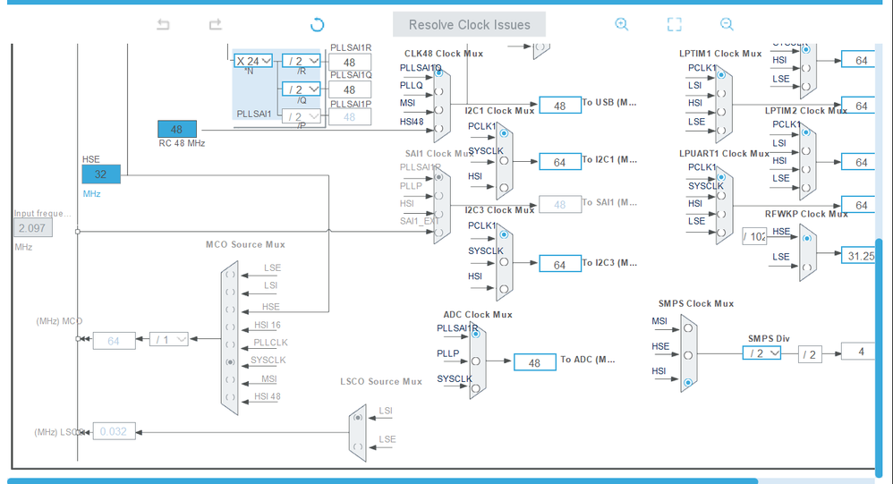

‎2024-06-10 7:31 AM
Here is Input frequency.. you can change it according to yours requirements.
HCLK frequency
Input frequency

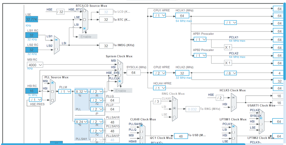

I am sorry, here is the full page (tell me if you can't see well).
For the clock, i don't really do anything, i let the seetings by default, i didn't really know how the clock configuration worked...

It looks like you're using MSI RC as your clock source? That may not be accurate enough as a baud rate clock.
Again, an external crystal (or crystal oscillator) would be best to get the accuracy required for async serial comms

In PLL Source MUX select HSI instead of MSI ... after again you have to select HCLK as maximum.
To select external crystal frequency
you need to go to RCC setting and select Cystal Resonator for HSE.
For more details I'll suggest you to go through with the Datasheet of yours device.
