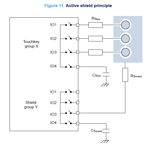

Hi Sir/Madam,
Here are developing a PCB with touch interface. We found the schematic files in st.com website. In that schematic, touch interface is not implemented. Can you please share the suitable link or any reference files to understand the TSC connections, So that it will be very much helpful to complete my project.

You can get details in AN5225 Getting started with touch sensing control on STM32 microcontrollers
Regarding sensors: See chapter 5.5
Regarding way to connect Sensor/shield and group: See chapter 5.5.4
With
CSkey = 47nF
RSkey = 10K
CShield = 100nF
RShield = 1K.

For developing a key, is there any necessity to enable the Shield group also?

No Shield will decrease the sensitivity.
So the best to do in your case is to reduce the length between the sensor and the MCU: no more than 20mm.

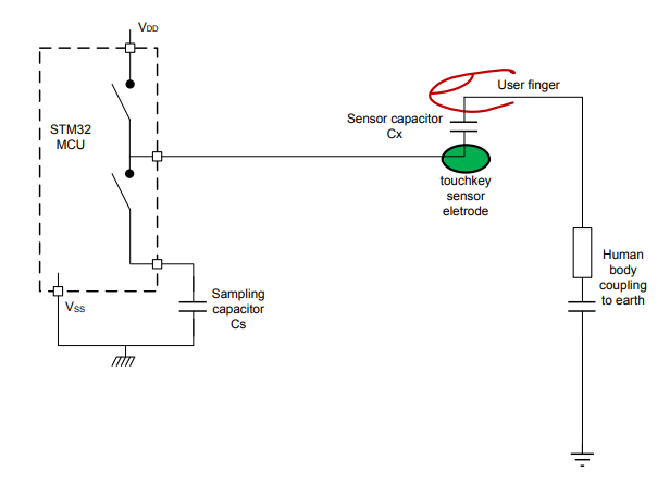

Hi Sir,
Actually in the AN5105, figure 1, has sensor capacitor Cx is used to place finger, Cx is charged and Humanbody coupling to earth. 0690X000009YnYpQAK.png
In case of the active shield, there is no sensor capacitor(Cx), Can u pls help me and what is the difference in both cases.
