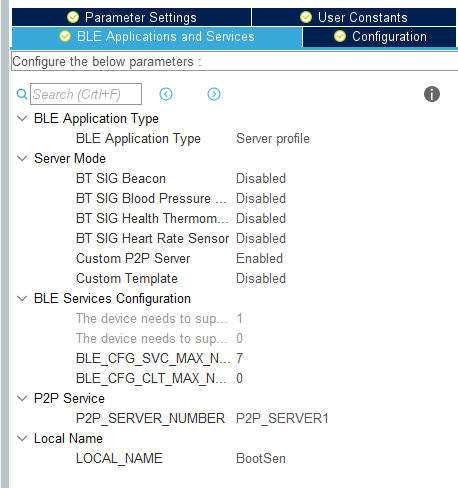

I have configured STM32_WPAN as follows:
My small application runs fine but I get no indication that the BLE is running at all. I am using ST BLE Sensor to scan but do not see my device.
Any pointers on where to look or what to check would be greatly appreciated.

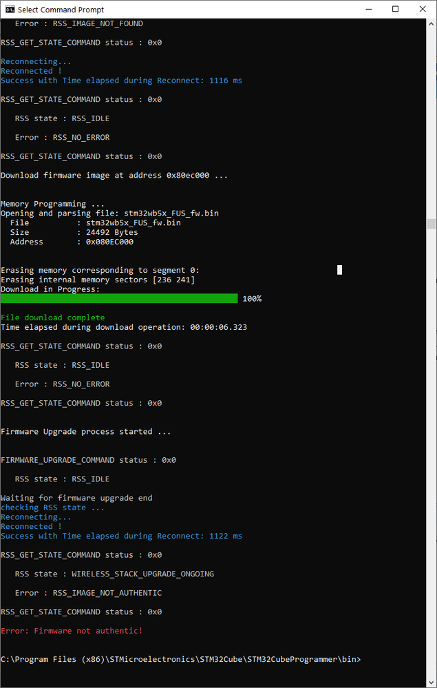

‎2019-06-17 12:51 PM
Moving on.
I now have STM32_Programmer_CLI.exe connected to my custom board using UART1. Now I am getting the "firmware not authentic" error message and can't seem to program the new stm32wb5x_FUS_fw.bin file.
Here is the last part of the attempt.
‎2019-06-17 2:03 PM
Ok, I am past this now. I used STM32CubeProgrammer to select all sectors and then Erase selected sectors. Full chip erase did not work. Once this was done the "firmware not authentic" error disappeared.

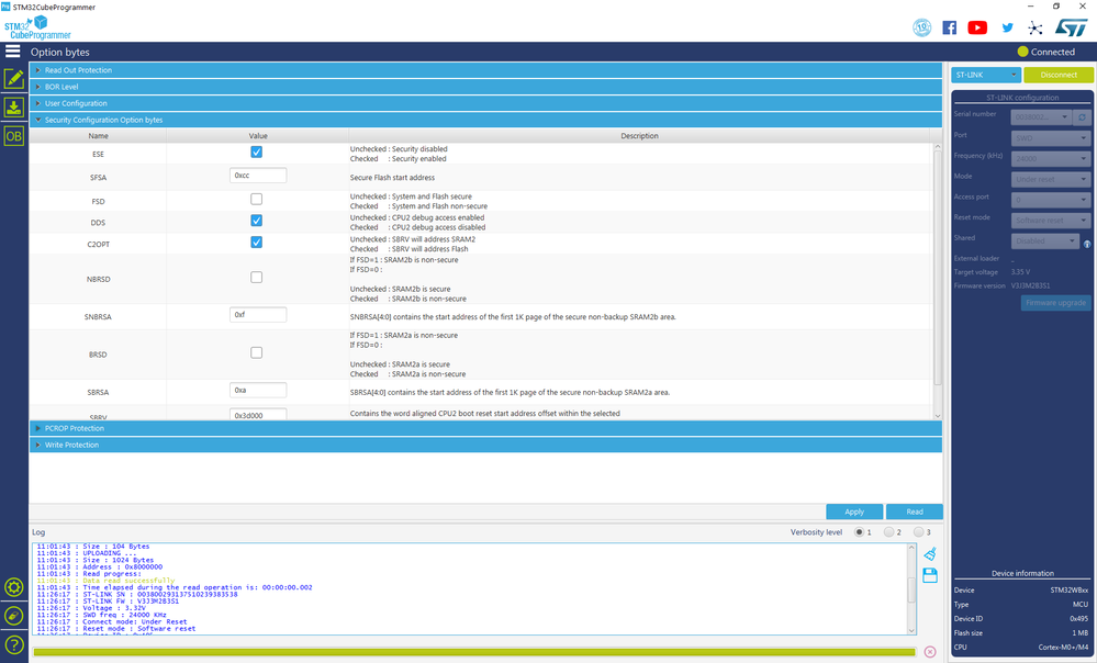

‎2019-06-19 9:31 AM
I am still not having any luck getting to the advertising state.
I have used the bootloader to program stm32wb5x_BLE_Stack_fw.bin at 0x080CC000. I believe that FUS and the BLE stack are both properly programmed.
I have included the call to SCH_Run(~0) in my main while(1) loop.
My program never hits APPE_SysUserEvtRx().
C2BOOT is set to 0x1 when I break in my while(1) loop.
Here are the settings from my Security Configuration Option Bytes:
Any ideas on what to check next would be greatly appreciated.

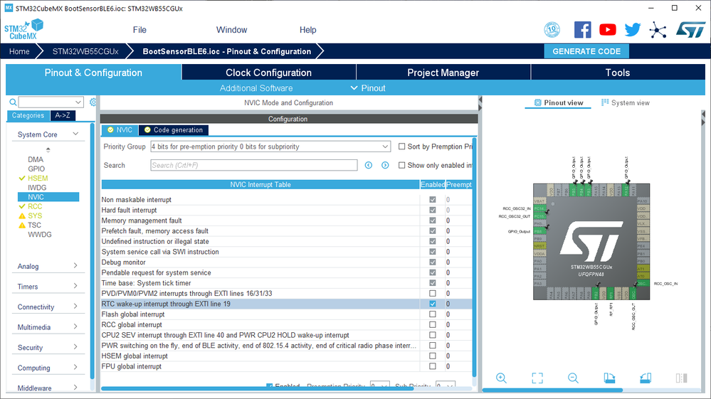

‎2019-06-28 6:00 AM
My board is finally working. To get it there I had to add the following code along with the two IPCC IRQ handlers.
* @brief This function handles RTC wake-up interrupt through EXTI line 19.
void RTC_WKUP_IRQHandler(void)
/* USER CODE BEGIN RTC_WKUP_IRQn 0 */
/* USER CODE END RTC_WKUP_IRQn 0 */
HAL_RTCEx_WakeUpTimerIRQHandler(&hrtc);
/* USER CODE BEGIN RTC_WKUP_IRQn 1 */
/* USER CODE END RTC_WKUP_IRQn 1 */
‎2019-06-28 6:23 AM
I had missed this step:
Works great now.

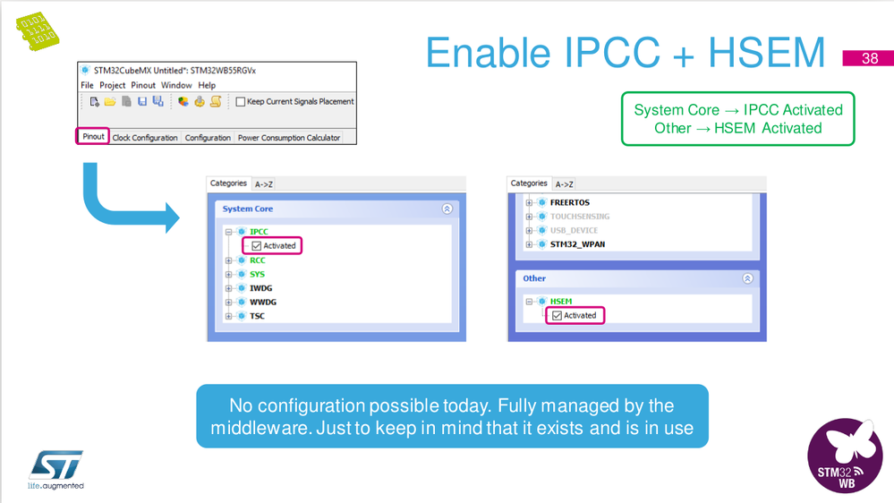

@STM: I would like to remind, that month has passed and problem is still present on STM32Cube FW_WB.
According to the STM's workshop presentation, there is an information, that WPAN middleware handles IPCC and HSEM, but apparently not...
For further newbie developers like me: keep in mind, that you have to add IPCC_C1_TX_IRQHandler and IPCC_C1_TX_IRQHandler definitions manually, make all steps which were described by Louis and remember to make sure, that you have SCH_Run(~0) in your main while loop. You will save lot of time.
