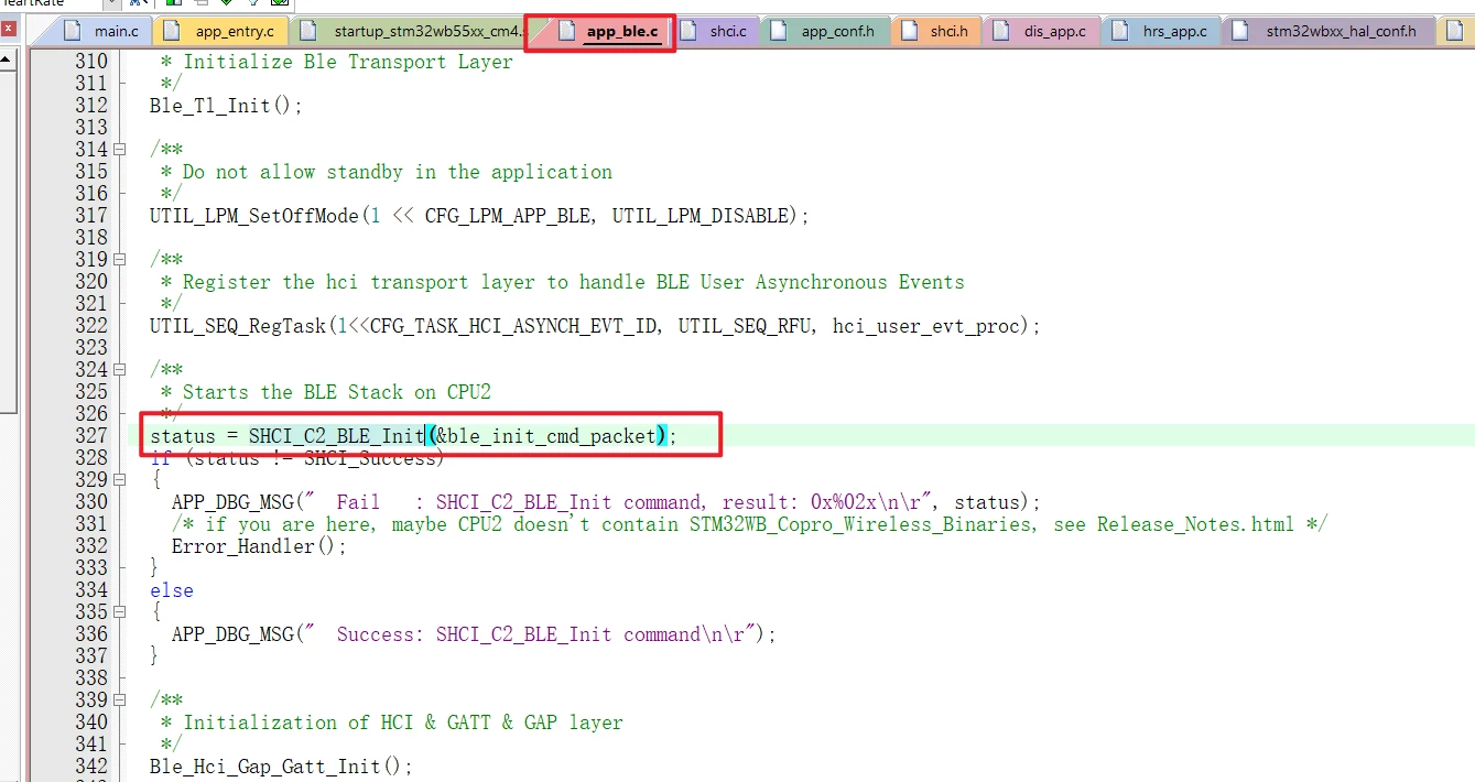

The program is stuck in SHCI_C2_BLE_Init
  • June 11, 2024
  • 1 reply
  • 1223 views
When I was debugging, I found that the program got stuck in SHCI_C2_BLE_Init, and it neither returned success nor failure.What is the reason for this? I correctly burned FUS and protocol stack when I confirmed, and the version also corresponds.

Hello @YUNLEI
I think you are facing to a known issue which is described in errata sheet ES0394, see the following extract:
"2.3.1 RF system wake-up clock set to HSE/1024 cannot be changed
Description:
Once the RFWKPSEL [1:0] bitfield of the RCC_CSR register is set to 11, setting it to any other value or performing a system reset prevents the RF system from waking with another wakeup clock.
Note: The value 11 of the bitfield selects HSE divided by 1024 as the RF system wakeup clock.
Workaround:
Apply a POR to change the RF system wakeup clock."
Best Regards.
STTwo-32
PS: after FUS and stack upgrade, have you started the wireless stack using Cube Programmer? If no, that may be also the reason behind this issue.
Best Regards.
