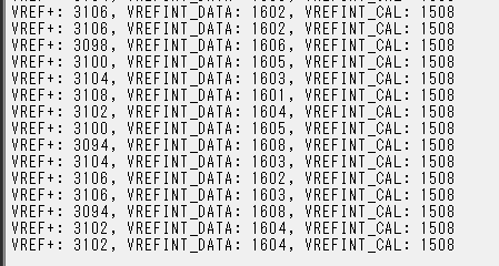

Hi, I am using VREF to calculating VDD. VDD = 3.3V but VREF = 3.0V. What wrong? (I use __LL_ADC_CALC_VREFANALOG_VOLTAGE() macro helper to calculate Vref). Does anyone have any tips what the issue might be? Thank.0693W00000Nqc76QAB.png

VREF+_Charac = 3300mV (datasheet)
VREFINT_CAL = 0x05E4 = 1508
but VREFINT_DATA is the actual value converted by ADC is 1608. Therefore VREF+ < VDD
0693W00000NqdceQAB.pngmy calculating code:
0693W00000Nqdf9QAB.pngprinted in Terminal:
0693W00000NqdfEQAR.pngPlease review for me. Thanks

Measure.VrefAnalog = __LL_ADC_CALC_VREFANALOG_VOLTAGE(ADC_RegularConvertedValueTab[MEASURE_ADC_VREF_ADDR], LL_ADC_RESOLUTION_12B);
xSystem.Vref = Measure.VrefAnalog;
DebugPrint("\rVREF+: %d, VREFINT_DATA: %d", xSystem.Vref, ADC_RegularConvertedValueTab[MEASURE_ADC_VREF_ADDR]);
DebugPrint(", VREFINT_CAL: %d", *VREFINT_CAL_ADDR);
