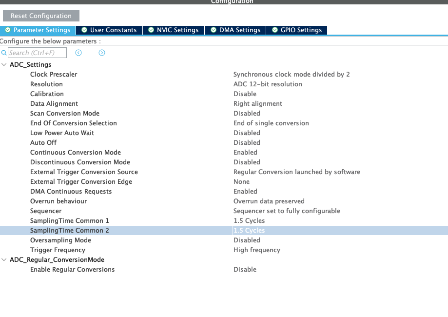

Sampling Time: 16 ADC clock cycle((12.5+1.5)*1/24MHz=0.58333µs)
here is my adjustment of adc:
here is my code:
uint32_t ADC_VAL[128];
void HAL_ADC_ConvCpltCallback(ADC_HandleTypeDef* hadc)
FFT(ADC_VAL,128,2048);
HAL_ADC_Start_DMA(&hadc,ADC_VAL,128);As I said before, I can use fft without problem with pooling and timer. I am writing 0.5 mikrosecond delay and thats it. I want to use dma but I couldn't manage it. How can I adjust sample rate with dma ? and if I do that, can I use accelerometer and microphone with out blocking each other ?
