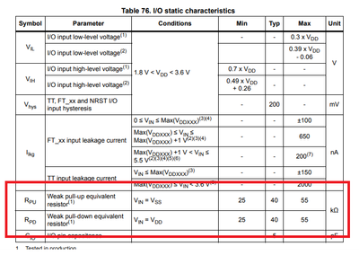

Hello team,
We are using STM32WL55 MCU. I haven't found any information about resistance value of its internal pull-down resistance.
As far as I know it is typically 40k. But could you tell what is the tolerance of this value?

Hello @mokluza and welcome to the community,
Min: 25K, Max 55k
From the datasheet:

mƎALLEm
Min: 25K, Max 55k
From the datasheet:

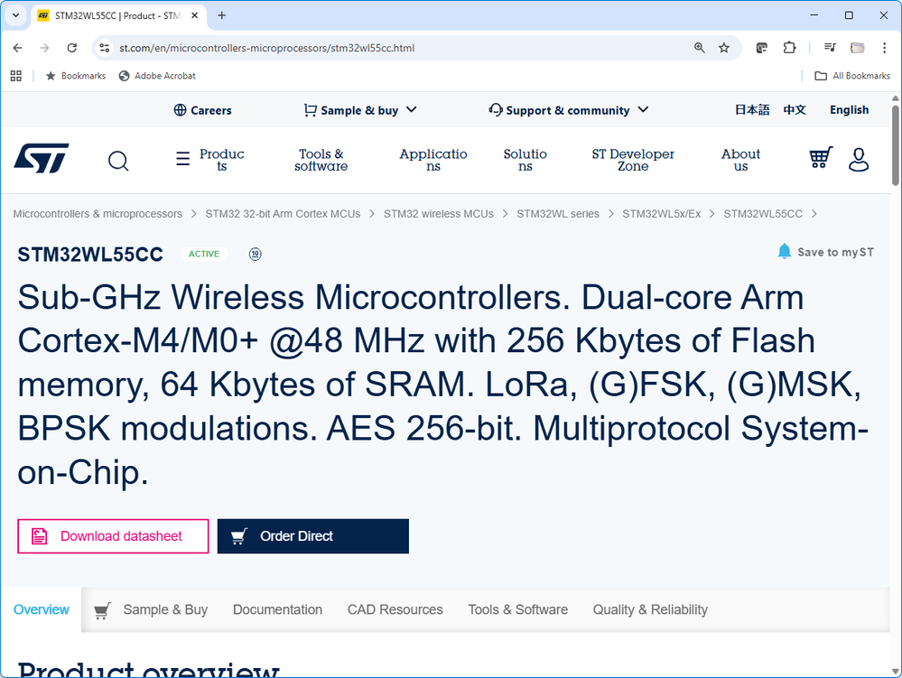

@mokluza wrote:
Unfortunately your datasheet link doesn't work for me. Could you send me direct link or the file?
Note that you can always find the datasheet (and more) by going to the Product Page for the chip in question:
https://www.st.com/en/microcontrollers-microprocessors/stm32wl55cc.html
You will also find it (and more) on the 'Documentation' tab:
https://www.st.com/en/microcontrollers-microprocessors/stm32wl55cc.html#documentation
