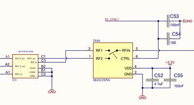

I did a hardware design based on the STM32WL55 chip + Balun and one line for controlling the radio, FE_CTRL1. I modified the HAL radio library for all the SET-RESET only using RF_SW_CTRL1 and added the RF_TCXO init and its VDD value 3V0.
The problem is that I can't communicate fully between the device and the network; it connects, sends the data (I see on the NS), and then freezes. I added some "logs" to print through the UART to check the process.

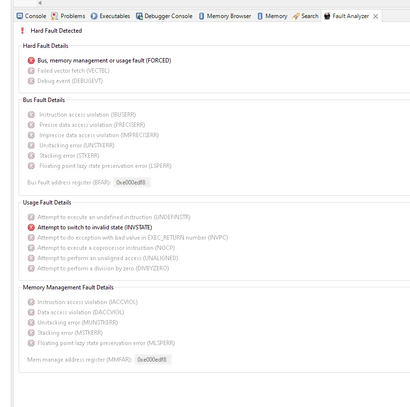

Despite that, I am having difficulty using a JTAG debugger through the SWDIO to see which part of the code is freezing. Any ideas I can test?

Part of the SCH
I am using the Balun WL-02D3 and a BGS12SN6 RF switch. I modified part of the code in stm32wlxx_nucleo_radio.c like this:

EDIT3: Hard fault view.
SOLUTION:
It was very easy, but took me longer than I thought. In the file sys_app.c there is a function that was making the MCU halt, despite I had no debug lines activated. It added the comment block, and it worked like a charm.
