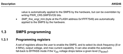

I have a custom board with a STM32WB5MMG module. In order to obtain the best performances, I want to use the STM32WB5MMG SMPS with a 3.3v voltage source. However, I can't find in the Cube IDE any command to activate the SMPS. Is it always activate? How can be used and activated?

From the datasheet:
and the reference it points to goes into detail on how to use SMPS or set it to bypass.
Thank you. I found that there is this define in app_config.h:
* SMPS supply
* SMPS not used when Set to 0
* SMPS used when Set to 1
#define CFG_USE_SMPS 1
