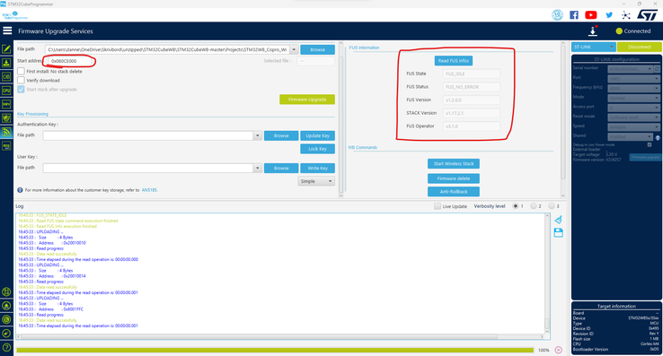

And when I went to CubeProgrammer and did "Read Fus infos", this is what I saw:
As you can see, the STACK version is v0.0.0.0, so I have to get the stack bin onto the chip.

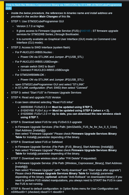

In the first image, on row 76 I am referred to a page, I go there and go to the "How to flash the Wireless Coprocessor Binary via SWD/JTAG ny ST-LINK (STM32CubeProgrammerGUI)"- section.

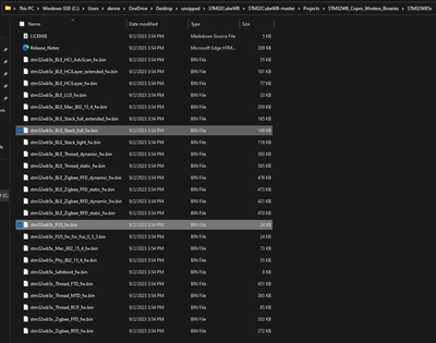

I went to
STM32CubeWB-master\Projects\STM32WB_Copro_Wireless_Binaries\STM32WB5x
and chose the stm32wb5x_BLE_Stack_full_fw.bin as said in the readme.txt in the project CubeIDE.

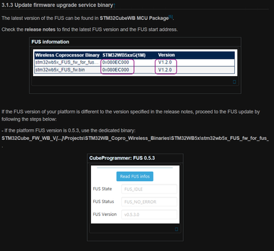

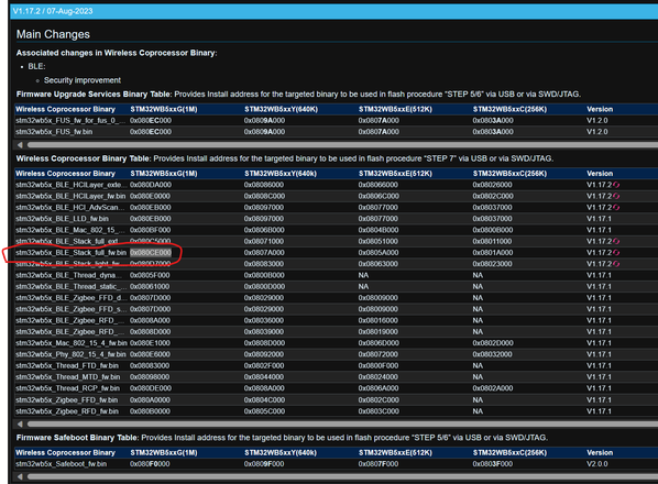

According to the guide, I need to check what Start address I should have, scrolling down I see thi s table:
I have an STM32WB5MMG and with the said .bin file, the start address I assume is
0x080CE000

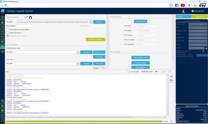

What I do next is in the "Firmware Upgrade Services" part of CubeProgrammer (that was shown in the second image), I choose the correct .bin file and put the 0x080CE000 address as start, then pressed "Firmware Upgrade", it was successful and when I then again press "Read FUS infos", this is the result:
 As you can see, the STACK version is now v1.17.2.1, so I think I did it successfully.

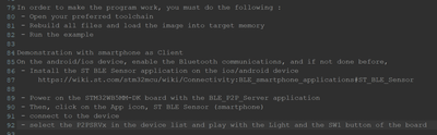

 If I then continue to read the readme file:
I see that I should now just be able to compile everything, upload and run. And from what I understand I should now see the device.

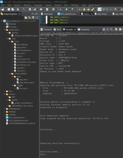

I compile and upload:
Now I check the apps (both BLE Sensor and BLE Toolbox), but I cannot see the device come up.

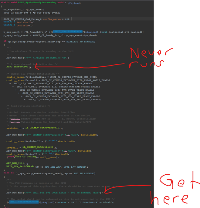

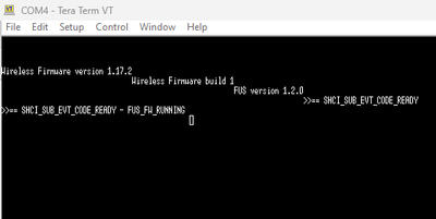

Just to add to the overall information, when I look at the serial output, this is what I see:
So from the terminal output, it looks like the EnableCPU2 function does never happen, I.e. this is not true:
if (p_sys_ready_event->sysevt_ready_rsp == WIRELESS_FW_RUNNING)
Instead the code goes into this:
else if (p_sys_ready_event->sysevt_ready_rsp == FUS_FW_RUNNING)
I am not sure if this is the behavior I am expecting. I just want to add as much information as possible so that someone maybe can spot something wrong.

I looked through the guide and notice in this part:
They say to use the FUS_fw bin file. But from the readme.txt I was pointed to Stack_full_fw.
Which file should I have in the "Firmware Upgrade" file path, and at which start address.
 Or maybe I am mixing up things here and I should flash the STACK somewhere, and the FUS at another place.
Could you clarify what I am supposed to do?
Thanks in advance

Jopail12
hello @DLid.1 ,
This forum post helped me debug this same issue.
You may need to press the "start wireless stack" button in stm32cubeprogrammer after updating the FUS and BLE Stack firmware.
