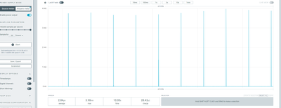

I seem to be having the same issue on the STM32 NUCLEO WL55JC1 board. I'm running code adapted from a firmware example that defaults to the STOP2 mode when there are no tasks, but there are periodic spikes that I can't understand. For more context, my ammeter is the nordic PPK 2 and I have my probe on the JP1 I_SOC jumper; the example i adapted from is the STM32WL Ping Pong example with LoRa modulation. Please help. Thank you. 
