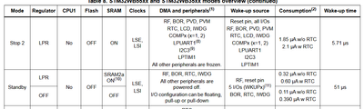

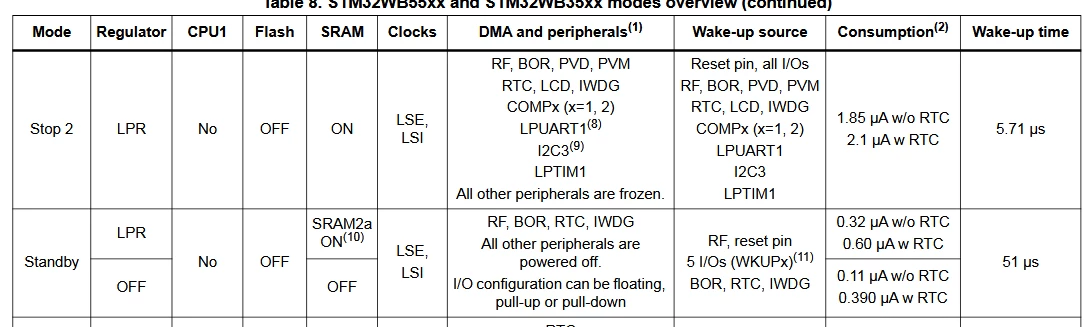

I am trying to use the standby mode. As the datasheet specifies, it can only wake up from this mode from the reset pin, wake-up pin, or RTC trigger.

As the documentation said, you must have no task schedule to enter sleep mode if the sequencer is running. If so the µc will automatically enter sleep mode (if you have CFG_LPM_SUPPORTED to 1).
To wake up you need to configure the pin as interrupt and in the interruption, you have to relaunch a specific task (of the scheduler).
But be careful because it is not the same mode as standby. When you wake up from sleep it does not go to the start (like the reset pin would do). (So I think the consumption is more important than a true standby)
