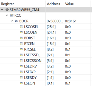

I'm working with the STM32WB55. I'm having difficulty getting RTC to work correctly.
The VBat is always powered by 3v3, I have an on/off switch that only removes the power from the VDD, however, when I turn it off and on the microcontroller is stuck in the routine: "while (LL_RCC_LSE_IsReady() == 0U)". I noticed that when CFG_HW_RESET_BY_FW is 1, the board continues to function, but it resets the RTC registers and the time is lost and when CFG_HW_RESET_BY_FW = 0, the firmware is stuck in the "while (LL_RCC_LSE_IsReady() == 0U)" routine. Looking through the oscilloscope, the clock is all right.

  • I saw on your screen that LSECSSD is equal to 0x1. It means a failure is detected on LSE (32 kHz oscillator) by the CSS. Have you try with the LSI clock ?

    • First enable LSE oscillator with LSEON
    • Then, wait the ready flag LSERDY (set by hardware)
    • And select the clock source with RTCSEL (= 0x1 for LSE)
    • Finally, enable LSECSSON. (Once enabled LSECSSON cannot be disabled, except after a LSE failure detection (LSECSSD = 1). In that case the software MUST disable the LSECSSON bit.)

  • Unfortunately, I just checked ES0394 and the issue is mentionned (it's n° 2.2.2 : Unstable LSI1 when it clocks RTC or CSS on LSE) You need to apply one of the following measures :
    • Clock the RTC with LSE or HSE/32, without using the CSS on LSE.
    • If LSI1 clocks the RTC or when the LSECSSON bit is set, reset the backup domain upon each VDD power
      up (when the BORRSTF flag is set). If VBAT is separate from VDD, also restore the RTC configuration,
      backup registers and anti-tampering configuration.

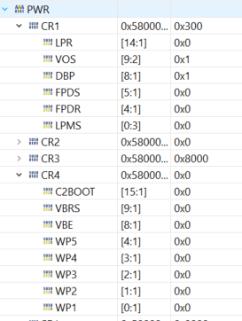

  • When you are stuck in the while, can you share the value of PWR_CR1, PWR_CR4RCC_BDCR (especially LSEON, LSEBYP bits) ?

- I need to make my RTC never reset, so the VBAT is always in 3v3, remembering that I am using a V3 stlink to power the circuit. I have an on/off switch that only interferes with VDD, that is, VBat always 3v3.
- Following are the values of the registers:
