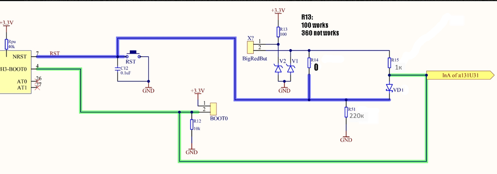

It will be interesting to know about reset system inside stm32wb55. I have got not casual reset schematic.
Where InA is digital Isolators IC input. I also tested without this IC and result is the same. Rpu is build-in stm32wb55 pull up resistor. R13 is 360 Ohms.

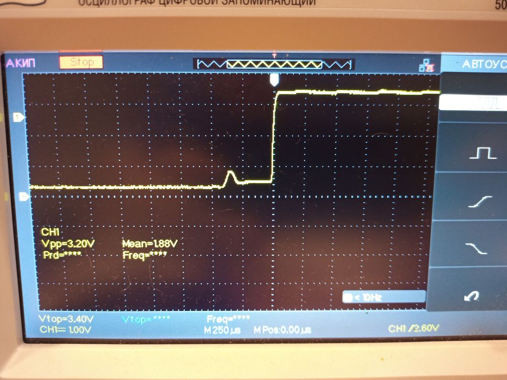

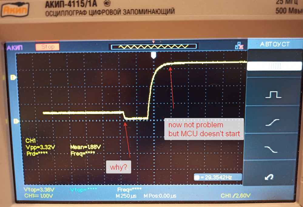

stm32wb55 doesnt't start! I am looking reset pin using oscilloscope
At some moment voltage drop! It looks strange, but after 500 us there is 3.3 V on reset pin but stm32wb55 doesnt't start!
I change R13 to 100 Ohms and look
Hill looks strange but stm32wb55 works!
Why MCU doesn't works with R13 360 Ohms?

@dungeonlords789​ - I am not a h/w guy, but if you don't know the answer to your own question, then why would you attempt to design a reset circuit for the STM32WB that is anything other than exactly what the ST designers created for their Nucleo dev board?
‎2020-12-24 3:59 AM
Because I have not enough pins.
