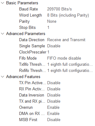

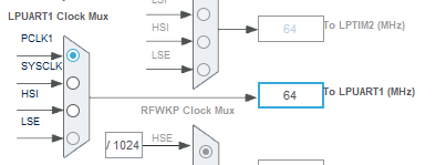

I was wondering what the maximum transfer speed is of the single wired (Half-Duplex) LPUART connection of the STM32WB55CGU. The clock configuration shows a clock frequency of 64Mhz, the baud rate is by default 209700 Bit/s. Is it possible to transfer at 1Mbit/s, or more?

yes, speeds above 1MBaud are possible. Theoretically you can go up to speed of (peripheral clock/3) which is in your case something above 21Mbaud.
But the LPUART is designed rather for low speed/low power consumption scenario. At extremely high speeds it will have higher error rates than regular USART peripheral, which features baud rate auto tuning and oversampling to improve com reliability.
If speed is the goal, consider normal USART peripheral in asynchronous mode.
