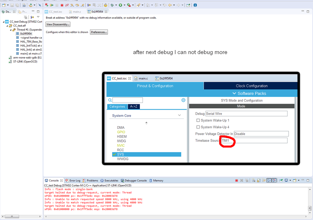

STM32CubeIDE 1.4.2 with 1.8.0 pack.

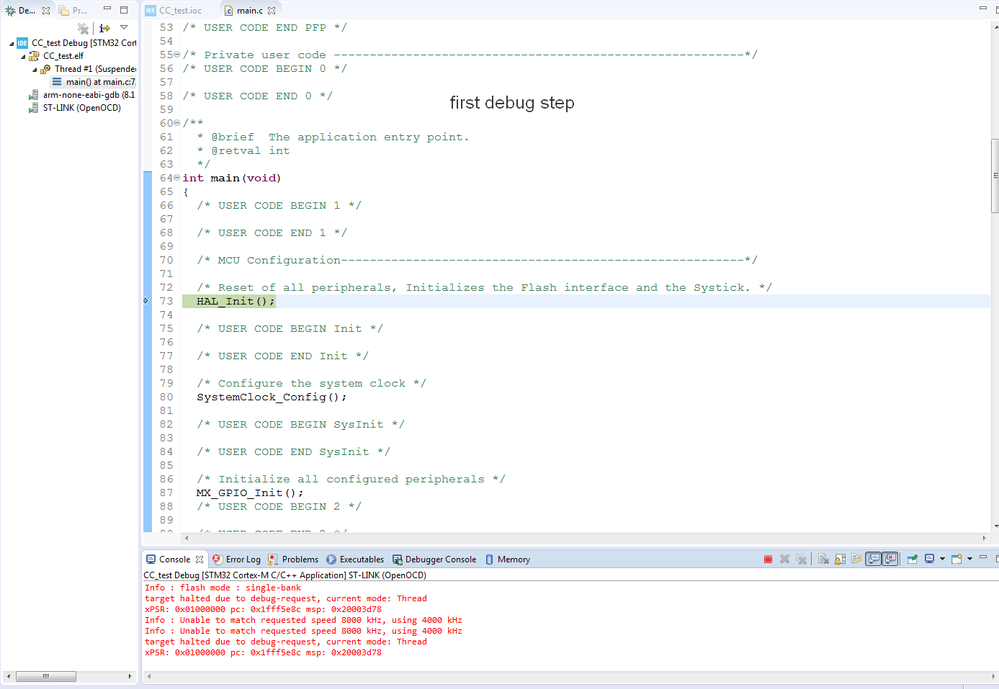

I generate new project for WB55CC in CubeIDE and try to do blink led:
I go to debug and do first step
I try to do second step, but prog going away.
This was "TIM1 problem". Next is about "Systick problem".

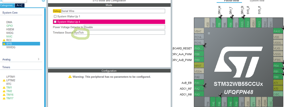

I select Timebase Sourse = SysTick, generate code. Debugger do all steps before while(1).

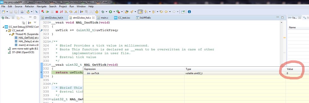

But after HAL_Delay(200) prog is infinity wating. I pause via debugger and I can see
Look at attachment.

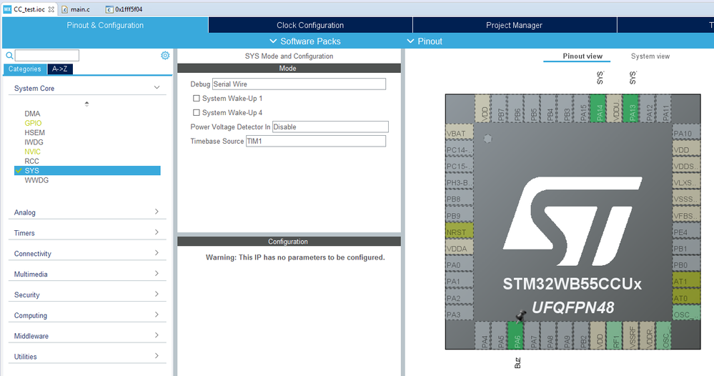

​Hello,
I added the STM32CubeMX stamp as I believe the problem is not linked to either BLE or STM32WB but more on the way STM32CubeMX has generated the application.
From the time being, I would recommend to have a look to \Projects\P-NUCLEO-WB55.Nucleo\Examples\HAL\HAL_TimeBase_TIM which provide an .ioc with TIM17 used to generate the tick for HAL_Delay().
