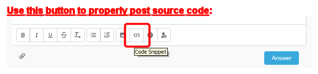

@Sean Park​ - even ST Employees don't know how to properly post source code to their own forum? :\
