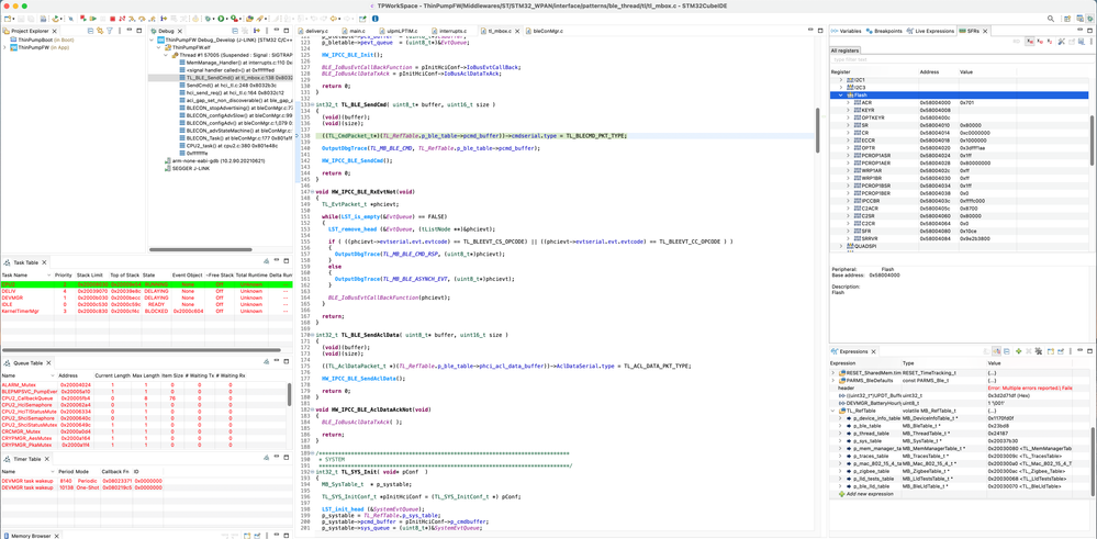

Can you confirm that your screenshot in your post where the TL_RefTable contains the hardfault keyword is taken with the BLE Full Stack v1.15.0.3? If it's not the case, can you share a screenshot which contain the TL_RefTable and give the corresponding stack version?
Best Regards
Thank you for that information. Yes, the TL_RefTable from the original post is v1.15.0.3. Here is another one from v1.16.0.4. I just took a screenshot of the state of the IDE. TL_RefTable is in the lower right corner. 0693W00000aJfDcQAK.png
Just as an FYI, the code I am running does not ever write flash.
Thanks,
Ben

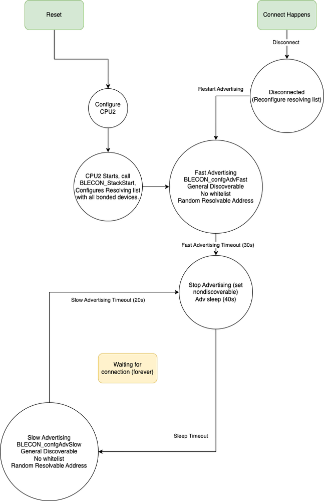

I have uploaded the code to the ticket. This issue takes a long time on my setup to reproduce. Sometimes it happens in hours, it could take up to a day. Rarely was I able to go overnight without the issue occurring. I tried various things like changing the way the advertising data was set or disabling STOP2 mode, the only thing that made the problem go away was to stop using random resolvable addresses and just rely on my static random address. So, just to be clear, we are a peripheral and we only support 1 connection at a time.
The code should have all the parameters passed to the BLE interface functions. If there is something missing you would like to see, shoot me a message.
I have created a basic flow chart of what our device is doing in this state.
At the end of a connection, we fast advertise for a bit, then take a break and shift to slow advertising. We enable and disable slow advertising until a new connection is established. We are a battery limited device, so we are trying to optimize current consumption while not connected to anything. We are not connected when this issue occurs, we are just advertising.
