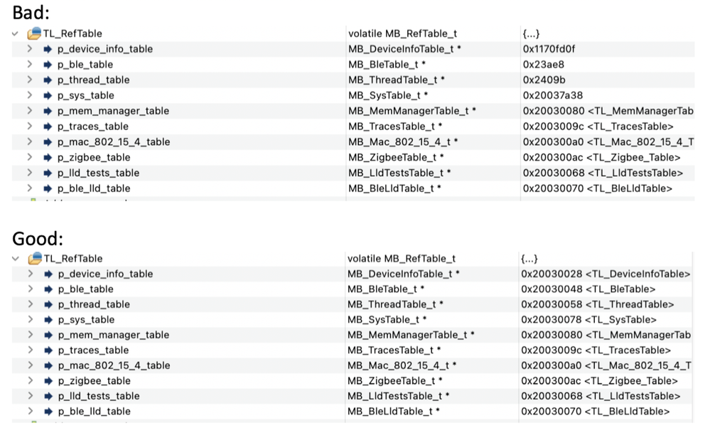

Ive seen this issue in various different forms over the last 2 years and it seems like CPU2 is corrupting the TL_RefTable structure while configuring advertising. We are using v1.15.0 of the stack on a STM32WB55. This happens every few hours in the following sequence.
aci_gap_set_non_discoverable();
// Wait 40 seconds
aci_hal_set_tx_power_level(1, powLevel);
aci_gap_set_discoverable(ADV_IND, RateMin, RateMax, addrType, NO_WHITE_LIST_USE, 0, NULL, 0, NULL, 0, 0);
aci_gap_update_adv_data(Manufacturing specific type)
aci_gap_update_adv_data(Name)
aci_gap_delete_ad_type(AD_TYPE_TX_POWER_LEVEL)
// Wait 20 seconds
Then the sequence repeats over and over until we get a connection. If I just let it run (over night for example) TL_RefTable gets corrupted and triggers an MPU fault on the next advertising sequence.
Why is this happening? What can I do to stop it?

According to your screenshot, you have an hardfault, indeed when the CPU2 enters in the hardfault interrupt handler, it writes the following data (extract of AN5289:(
@SRAM2A_BASE: 0x1170FD0F Keyword that identifies a hardfault issue
@SRAM2A_BASE + 4 Program counter value that generated the hardfault
@SRAM2A_BASE + 8 Link register value when the instruction that generated the hardfault has been executed
@SRAM2A_BASE + 12 Stack pointer value when the instruction that generated the hardfault has been executed
With this information, you can find which instruction generate the hard fault in your application.
Best Regards
Yes, the hard fault is generated when we deference the bad pointers in TL_RefTable the next time we attempt to send a command to CPU2. The problem is that CPU2 is corrupting the table. See the table in the above screenshot.
Also, I tried this in v1.16.0 stack and the problem is still there.

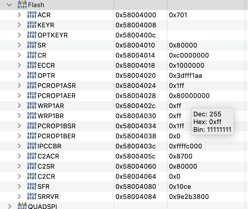

Remy ISSALYS
Previous action generates the hardfault, so CPU2 write hardfault keyword in SRAM2A, then when you attempt to send a new command to CPU2, you see this hardfault keyword.
Which stack and which version are you using? When the hardfault occurred, can you check flash register value (FLASH_C2SR (CPU2) and FLASH_SR (CPU1) register)?
Best Regards
I am looking through traces to see what is happening on CPU1 when this occurs, but not much is happening. We are basically enabling and disabling advertising. I see this issue both on v1.15.3 and v1.16.0 of the stack. I have tried both the BLE_*full_fw and BLE*_full_extended_fw versions of the stack. I have even switched over from the legacy version of advertising to the extended. Same issue. I will check the flash registers.
Hello, sorry for the delay. This issue takes a while to duplicate. The FLASH_C2SR is 0x80000 and FLASH_SR is 0x80000. 0693W00000aJaR5QAK.pngWhat is the significance of the flash registers?
