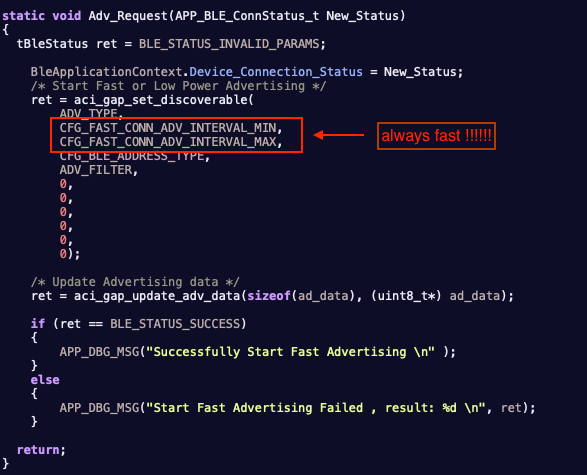

In code generation I can't start advertising with low power mode by change APP_BLE_FAST_ADV to APP_BLE_LP_ADV in Adv_Request(APP_BLE_LP_ADV); function.
because in this function always with fast mode ?
0693W00000QNICeQAP.pngsolution
BleApplicationContext.Device_Connection_Status = NewStatus;
  /* Start Fast or Low Power Advertising */
  ret = aci_gap_set_discoverable(ADV_TYPE,
		  NewStatus == APP_BLE_FAST_ADV ? CFG_FAST_CONN_ADV_INTERVAL_MIN : CFG_LP_CONN_ADV_INTERVAL_MIN,
				  NewStatus == APP_BLE_FAST_ADV ?  CFG_FAST_CONN_ADV_INTERVAL_MAX : CFG_LP_CONN_ADV_INTERVAL_MAX,
                                 CFG_BLE_ADDRESS_TYPE,
                                 ADV_FILTER,
                                 0,
                                 0,
                                 0,
                                 0,
                                 0,
                                 0);
