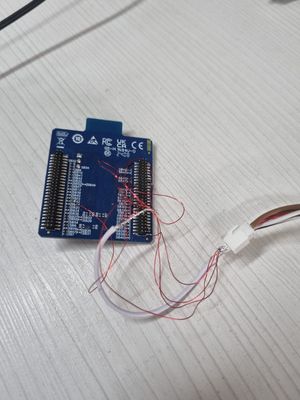

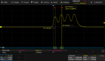

I'm having an issue with the SPI clock on the NUCLEO MB2032 board. As you can see in the image, I only have the debugger connected, and the clock signal isn't completely square.
In the code, the only thing I'm running is the following:

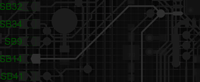

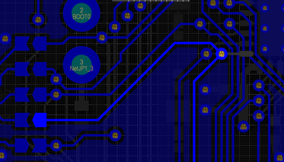

What I'm measuring with the oscilloscope is pin SB14, which, according to the PCB file provided by ST, is directly connected to the SPI clock.
Ensure pin speed for the SPI pins is set to VERY HIGH FREQUENCY or whatever the highest is for your chip.

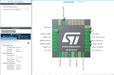

Thank you very much for your help, TDK. I solved the problem by checking for inconsistencies in the SPI configuration. I set a prescaler of 32 (baud rate = 1000 KBits/s), and it started generating a clean square wave signal.
I tried setting the clock pin to the maximum frequency, but the signal still looked inconsistent (not like a proper square wave).
