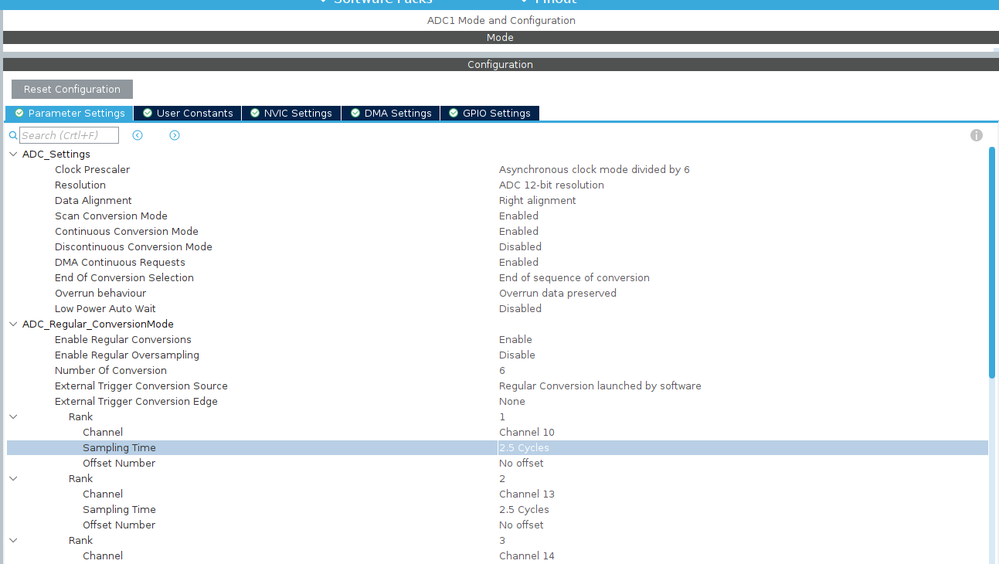

I'm using multi channel ADC with STM32WB having DMA activated
My issue is, every time when i perform the power ON reset, at the same time the channel sequence getting change!
It means, the conversion buffer in HAL_ADC_ConvCpltCallback function sequence is getting change
I have verified the same thing manually by connecting the 3.3V & GND at the particular channels
For example, when i connect the 3.3v at PC4 then the allocated buffer variable shows 4096 samples. However when i do the power on reset then some different buffer shows the value 4096
I have activated the 6 channels here with DMA
I have shared ADC initialization code snippet here
Can any one help me here ?
All suggestions & comments welcome
Thanks

I don't think there's an issue in the code you've shown. I would imagine there's a bug somewhere else, perhaps in how you're calling HAL_ADC_Start*.
Note that 6 samples don't fit evenly into a buffer of 4096.
Hi.. @TDK​
Thanks for your feedback
You're right!
Actually, I'm using the BLE Stack to send the Analog sensors data to android app with custom GATT services
I was triggering the DMA of the ADC when user start the services from the app and stopping it when user stop the services
The issue with the stop api that i was using previously
Instead of the stopping the DMA, i was stopping the ADC by calling HAL_ADC_Stop
So, when again user trigger the GATT services from smart phone then,, HAL_ADC_Start_DMA calling which was failing as the ADC engine went off from the previous cycle
Adding the HAL_ADC_Stop_DMA api to stop the adc has been solved the issue
