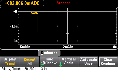

So this is my third day working on this problem.
I have created an P2P server project based after the example and the MOOC videos.
It works just fine, no problem during the first 60 seconds.
The current consumption is around 200uA during advertising.
But when the advertising stops the current goes up to 2.0 - 2.5mA
I have compared the p2p server project example file by file, and there is nothing that i can find that could cause this.

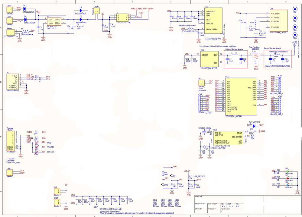

lizerd
Here is the schematic.
lizerd
if I change app_ble.c so it do not call aci_gap_set_non_discoverable();, then the consumption go down til 18uA during APP_BLE_LP_ADV
from
static void Adv_Cancel( void )
  if (BleApplicationContext.Device_Connection_Status != APP_BLE_CONNECTED_SERVER)
    tBleStatus result = 0x00;
    result = aci_gap_set_non_discoverable();
    BleApplicationContext.Device_Connection_Status = APP_BLE_IDLE;
    if (result == BLE_STATUS_SUCCESS)
      APP_DBG_MSG("  \r\n\r");APP_DBG_MSG("** STOP ADVERTISING **  \r\n\r");
    else
      APP_DBG_MSG("** STOP ADVERTISING **  Failed \r\n\r");
to
	  Adv_Request(APP_BLE_LP_ADV);
but as soon I call the aci_gap_set_non_discoverable(); the MCU current goes up to 2.0mA

EIvan.2
I have the exact same problem. After calling aci_gap_set_non_discoverable() the advertising stops, but the chip starts consuming 2 mA.
I don't understand what's wrong? I use STM32WB30 and stm32wb3x_BLE_Stack_full_fw.bin V1.12.0
Remi QUINTIN
This is a known issue resulting from the Flash protection mechanism.
This issue is corrected in the next WB FW version v1.13 that should be available on st site very soon.

Scott Löhr
Senior II
FYI: it looks like this issue is indeed fixed in v1.13.0 (but at a cost of 3 more flash pages for the CPU2 code).
