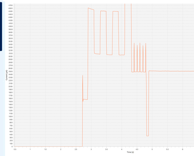

if i try to set my stm32wb55cg into standby, it seems to only work if the RFWakeupCLK is HSE-DIV1024

If i set the RF-WakeupClock to LSE it gives me:

So if i now try to enter Standby, it seems like the minimum it is now doing something else but no STANDBY :(

So this is working when the RFWakeupClock is HSE-DIV1024 but not with LSE.
I currently have no real clue why, i tried already so many different things -> regenerating the setup again and again with CubeMX but no success.
As soon as i set the rfwakeup clk to lse it somehow immediatly gets out of standby.
As attachment i provide a power graph:
At around 4.7 sec you see the drop to standby (maybe), but then some wakeup happens and it goes up to RUN, and there it stays now forever.

Power consumption you observe at ~4.7s cannot be standby, it's still too high - depending on the configuration you shall be able to reach <1 uA, you get for a while ~360 uA!

Only with that it is working an the controller is going to standby. I measured the consumption and it is around 0.7 uA.
But as soon as I change the RF wakeup clock to LSE the result is like shown in the last picture of my post. The controller then does not stay anymore in standby sadly.
