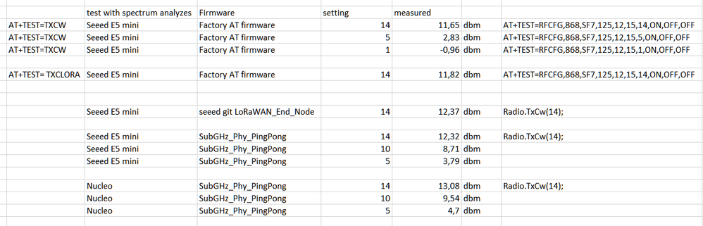

i'm just sitting and messing with a few lora boards.
I find that nucleo-WL55JC1 has approx 10dbm RSSI better than seeed LoRa-E5, and that nucleo-WL55JC1 also transmits with a more powerful signal, what is your experience ??

i found the error, it was the clock domain for the one gpio pin that was not right, so the one gpio did not work .. :)
my measurements if anyone could be interested ..
0693W00000NrJXWQA3.pngNucleo is a littel bit better.

How, exactly, are you determining that?
What, exactly, do you mean by, "seeed LoRa-E5" - a board? a module?
0693W00000NqYZGQA3.pnghttps://www.seeedstudio.com/LoRa-E5-Wireless-Module-p-4745.html
Antennas are bidirectional - so you'd expect better performance in Rx to be reflected in better Tx.

How does a GPIO pin mis-configuration affect RSSI?
Please mark the solution:
spa23
Because that it was one of the rf switch control pins, so the rf switch never switched.
Aha - that'd do it!
