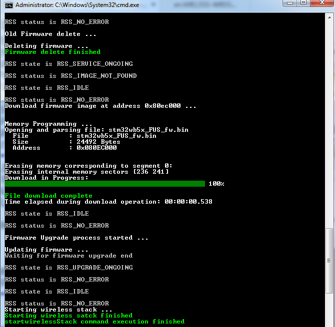

Is STLINK enough to load the binaries to CPU2 or we need to have access to the STM32WB USB port?
STLINK will be enough. The latest version can now update wireless binaries. Keep in mind that when using STLINK you won't get back version of FUS by reading RAM as per update instruction manual. Some identification commands also don't work, but you can update FUS and wireless binaries.
Also note that CPU2 uses same FLASH only that you can protect part of FLASH from access from CPU1. This is done during manufacturing with preloading of FUS/BT.
Thank you. It worked with ST-LINK. I wasted a lot of time reprogramming the images repeatedly because the RAM values always gave 0x00. Thanks for the clarification.

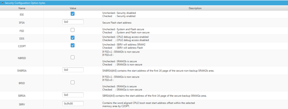

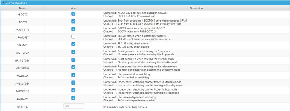

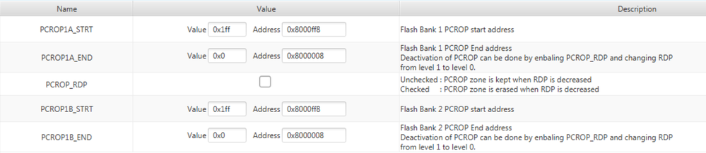

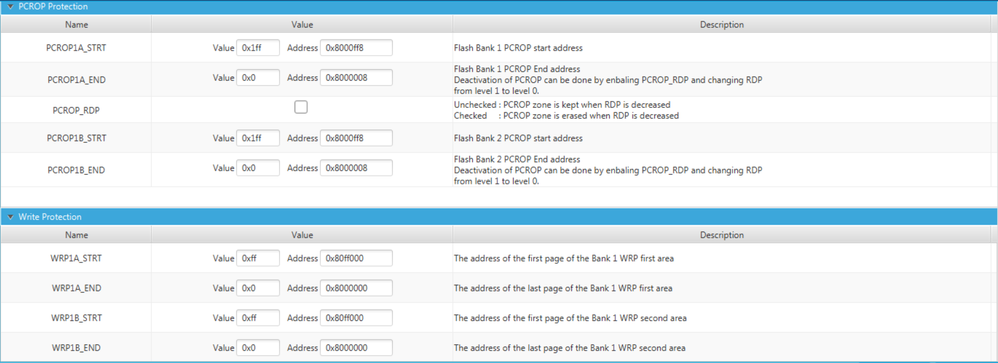

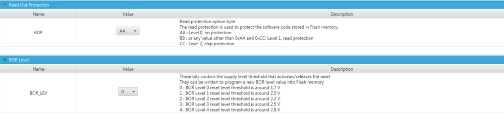

Tried that, and my controller is now permanently read-protected! I am unable to revert it to its normal functionality.
Please find attached screenshots of the current status of the option bytes.
It would be really appreciable if anyone could guide me to the current state of my device, and whether it is recoverable.

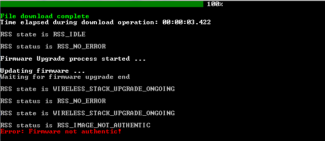

Thank you! This worked for me as well. As someone noted above, the "not authentic!" problem started after I tried installing to the wrong start address. I followed your steps and now have it updated.
