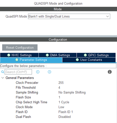

I'm using a Nucleo-WB55RE board with Quad SPI in single mode.  I'm trying to start very simply by just reading the chip id from a Riverdi BT81X display.  I have captured two waveforms, one via a Nucleo-446 board using regular SPI and one from the WB55.
My QUAD SPI settings are as follows:

I also had to change the Fifo Threshold = 1.
It would be extremely helpful in CubeMX if you were presented with "real" assistance.  When you click on Fifo Threshold you get:
Fifo Threshold
Fifo Threshold must be between 1 and 32.
Yeah, that's real helpful.  You end up spending an hour trying to find what the heck a Fifo Threshold is and what to set it too.

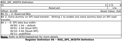

As per the DS and the Programming Guid the BT817Q supports Quad SPI.
I'm using the Riverdi RVT50HQBNWC00-B display which contains the BT817Q EVE4 chip.  I currently have the display connected to the QUADSPI port of the Nucleo-WB55RG board.  I was trying to confirm that I could "talk" to the display by getting the ChipID.  Once that connection is made, then I need to set the REG_SPI_WIDTH to tell the chip to operate in Quad SPI mode.  I think this is going to be a very difficult task.

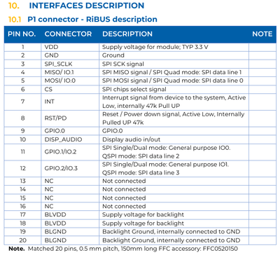

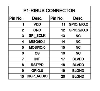

I currently have it connected per the Riverdi DS:
I initially was trying to get single mode running because the CMD section is only accessible through single spi and then I was going to switch it to Quad SPI and get that working. But yes, I agree, trying to get this to work has become a time suck and as you said, running it via QSPI doesn't really buy anything.  Thank you for pointing that out.
