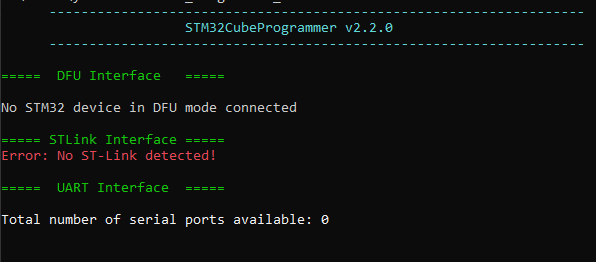

My problem is the following, I cannot connect to bootloader mode of nucleo board and my custom pcb with wb55rgv6.
For Nucleo wb55 board, I do exactly as precised in the documentation, I connect CN7.5 and CN7.7 to put BOOT0 to VDD. I connect JP1 to USB MCU and finally, I connect USB cable to USB_USER. I run STM32CubeProgrammer, I switch to USB connection and there I do not see any device in DFU mode. If I do it in command line, I execute the following command "STM32_Programmer_CLI.exe -l" to list all peripherals that I can connect to but it sys me that there is nothing. I precise that I can do both ways with USB dongle in Bootloader/DFU mode and that driver is up to date, it is the 2018 version delivered with last version of STM32CubeProgrammer.

Remi QUINTIN
​Your HW settings are correct.
Be sure to close the Cube Programmer (graphical version) before sending any command with the command line interface.
Then run the command STM32_Programmer_CLI.exe -l.
Are you using the last Cube Programmer version V2.2?

Remi QUINTIN
​Could you show me the list of command you are using to update your FW in CLI mode?
But I must admit that if you can do it correctly with your dongle, those commands should not be the cause of this issue.
Can you try the STLINK configuration  (Move the JP1 jumper to the USB STL position and switch to the UB STLINK connector) and launch only the STM32_Programmer_CLI.exe -l command. Just to check if it could be a kind of HW issue.
If it is detected, I recommend to use this SWD interface to upgrade your FW and application. With Cube Programmer V2.2, you can do,  via this SWD interface, all the update operations you could do via the USB-DFU interface.

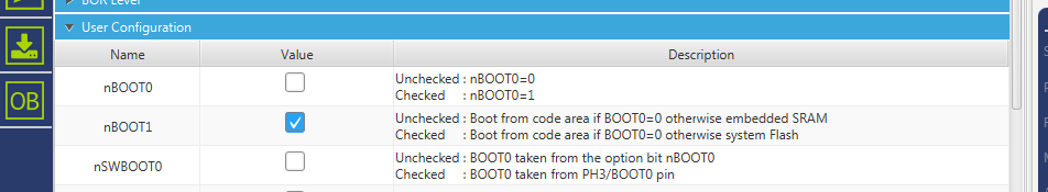

YSart.830
Thanks to support team by email, we found the solution to connect to DFU Mode. Via STLink and STM32CubeProgrammer, I configured user configurations like the following :
That way, it does not rely on PH3 pin and I can connect to custom board and eval board in DFU Mode !
But I still have a problem, if I run the BLE_OTA example (or any custom ble application), after starting the CMO+ core, I never get the signal that it is ready to handle commands coming from Cortex M4 ("p_sys_event->subevtcode == SHCI_SUB_EVT_CODE_READY" line 202 of BLE_OTA example), so it never starts BLE application on my custom board but it works perfectly with nucleo board.
