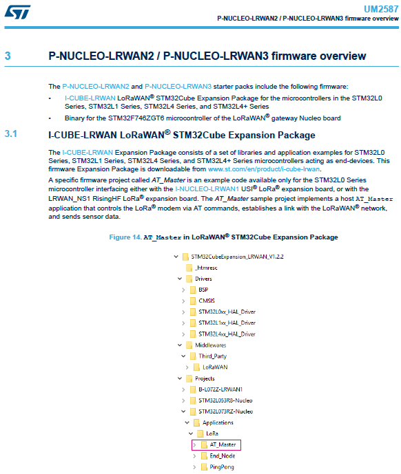

In the manual (UM2587) "Getting started with the P-NUCLEO-LRWAN2 and P-NUCLEO-LRWAN3 starter packs" on page 10 is that statemaent:
My endnode NUCLEO-L073RZ falls into that range, and therefor I have to change the sotfware. In the softwarepackage of i-cube-lrwan are parts related to different MCU and also to different 'cases' (AT_Master and End_Node).
I guess I have to select the part STM32-L073RZ, but what case (AT-Master or End-Note).
in the documentation i found no hit what is preloaded for the endnode.

This:
0693W00000BcgK8QAJ.pngis referring to the I-CUBE-LRWAN software expansion pack.

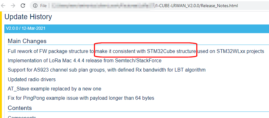

However, it seems that the AT_Master project in the I-CUBE-LRWAN v2.0.0 pack is broken:
https://community.st.com/s/question/0D53W00000vP1XtSAK/icubelrwan-v200-with-nucleol073rz-board-and-inucleolrwan1-shield
:pouting_face:
I have an old download of v1.3.1 - and that works OK.
