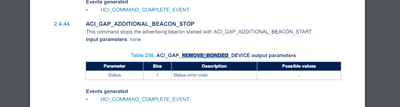

Pro bono publico, I also I believe you have a typo in AN5270:

First, thank you for reporting this Typo, I've escalated it to the concerned team for correction ASAP (under internal ticket number 183137).
