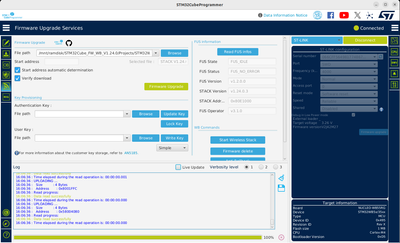

I am unable to successfully run zephyr samples/bluetooth/peripheral on nucleo_wb55rg.  The software appears to enter a fault handler.  The basic blinky project does work (samples/basic/blinky)

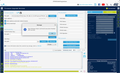

Wireless stack stm32wb5x_BLE_HCILayer_fw.bin v1.24 is programmed and running (see attachments)  I have also tried v1.23 without success.
Is there a known good combination of software and hardware for stm32 BLE and zephyr?
