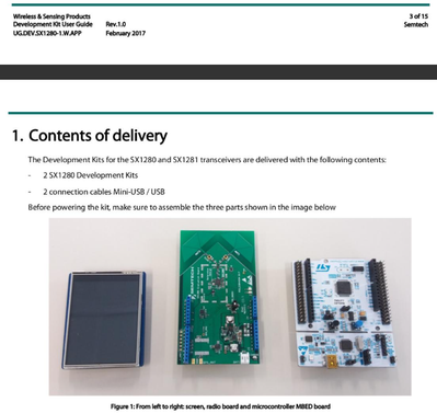

As @jamessmite says, see Semtech's site for drivers, SDK, etc for their chips
https://www.semtech.com/products/wireless-rf/lora-connect/sx1280 - see the 'Software' tab.
Note that Semtech's own devkit for the SX1280 is based on an STM32 Nucleo board:

@JamesParking wrote:
a Semtech SX1280 Evaluation Board
What board, exactly ?
Make sure that it doesn't interfere with the VCP connection (on Arduino pins D0,D1) ...
First try to get just the VCP connection working without this extra board attached

You still haven't said what SX1280 board you are using.
Yes, sorry I'm using the SX1280ED1ZHP
