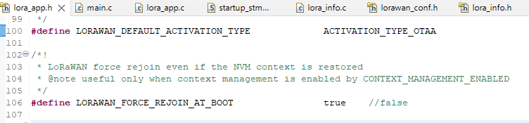

I'm using STM32Cube_FW_WL_V1.3.0and trying to generate LoRaWAN End Node FreeRTOS. I precedently set in file se-identity.h values for LORAWAN_APP_KEY,LORAWAN, LORAWAN_NWK_KEY,LORAWAN_JOIN_EUI, as shown in the guide and everything went fine.
Now I want to assign them new values in the same manner, but after compiling the project and programming the device with ST-LINK, on boot in the serial output it shows the first ones that I set:
APPLICATION_VERSION: V1.3.0
MW_LORAWAN_VERSION: V2.5.0
MW_RADIO_VERSION: V1.3.0
L2_SPEC_VERSION: V1.0.4
RP_SPEC_VERSION: V2-1.0.1
NVM DATA RESTORED
###### AppKey: F2:54:51:E9:24:11:25:F7:A5:24:80:97:32:CC:58:CD
###### NwkKey: F2:54:51:E9:24:11:25:F7:A5:24:80:97:32:CC:58:CD
The output shows that the values was restored from NVM, but I can't manage to change them in NVM.
How can I force the new values into NVM. Related to this, how does the BUT3_Pin work? It activates thread Thd_LoraStoreContext ( that calls the func LmHandlerNvmDataStore) but seems it not store the new values
Can anyone show me how do or what is the problem?

‎2024-06-12 11:18 AM
Hello, you just need to change line 100 in the lora_app.h file to set #define LORAWAN_FORCE_REJOIN_AT_BOOT to true (the default value is false). This will force the device to rejoin. Otherwise, the device will restore data from the non-volatile memory.
thanks.
