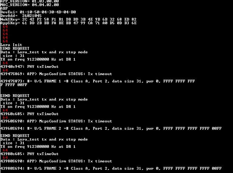

I have connected a Nicerf SX1262 us915 lora module with the STM32L496RG MCU. Lora module has DIO1 and Busy pins for tx and rx confirmation(data send and receive ).
I'm using STM32CubeExpansion_LRWAN_V1.3.1 library and i have used sx1262 example which is sx1262dvk1das. This code is properly working and its generate also interrupt on dio1 and busy pins at exact time but its occurs tx timeout or give on serial port window txtimout. I also get proper data on my gateway and server which is on ttn.
I dont know where is the problem. Interrupt fired on proper time. I checked all physical connections which is properly connected. I'm sharing my serial window data. where 64 is dio1 pin interrupt. .

i use in a custom board a DORJI DRF1262T module that contain the sx1262.
i use also the i-cube-lrwan package and the sx12621das projet.
i have the same problem than you and i have the PHY txTimeout directly after the AppKey and everything is stopped. i join a file with the point where the program is bloqued!! the PHY txTimeout is acquired after 4s112ms of the run. in the file there's a bigger value because i made step by step execution to see where the program bloc!!
it's not a hardware problem because i used the ping pong program provided by dorji and the board communicate well with other bord so lora operate well.
But i think that's a problem of lorawan protocole and that the DIO1 interruption is not handled ( i read this on the net) but i don't know how arrange this problem!!! i'm an electronic engineer and a biginner on soft development!!
So please did you already find solution for your problem? if yes can you please share it ? it will help me a lot
Thank you and for everybody who can help
Best regards

Thank you clive1 for your quick answer
i don't know why you say that there's a disproportion in the data parameter and the time on air!!! how can i verify this?
When i see SPI signal and CS and DIO1 interruption, it seem correct.
Please see the DIO1_INTERRUPT and CS_PIN file.
yelow trace : SPI SCLK
Green trace : SPI MOSI
Blue trace : SPI MISO
Pink trace : CS or DIO1 depending the name of the file
I think it's a problem of the interrupt handling, problem of callback or something like that ( i already readed this on the net : https://github.com/Lora-net/LoRaMac-node/issues/806 ).
Can you tell me please what do you think and what's the solution?
It is a hypothesis about where a "Tx Timeout" might occur. I know for a fact that the "Rx Timeout" can fire while it is actually receiving data, at least in some iterations of the stack, it is triggered by a timer independently of the radio, and it's not cleared by the reception of initial symbols or preamble. In that scenario the "timeout" needs to include the max time between messages, and the max message length/time that could be received after that.
The second one was if the radio didn't get the messages that it was supposed to do anything, and thus failed to complete in the assigned time frame. Your github cite seems to suggest a similar problem.
You would need to look at DIO1_INTERRUPT in the context of where the "Tx Timeout" condition is asserting, or TimerStart vs Timeout.
The state of the radio vs the stacks expectation for it to do something.
For SPI issues you'd want to concern yourself about the CS LOW to DATA OUT phase, and later the CS HIGH to CS LOW minimums between consecutive interactions.
You might want to change the compiler optimization settings, and see if there is something amiss there.
