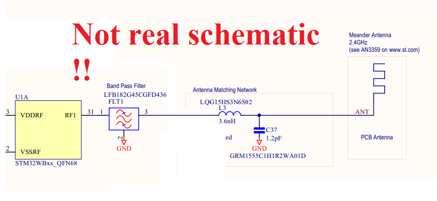

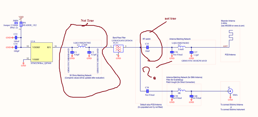

In the User Manual UM2435  for Nucleo STM32 provided the next schematic
0693W00000Y9ysRQAR.bmpBut in PCB we see the next 0693W00000Y9ysWQAR.bmpI think that the next schematic is actual, is it correct?

Hello @IRakh.1​ ,
You can refer to P-NUCLEO-WB55 schematics boards shared in ST web site.
For that, if you have C02 board revision, you can refer to the MB1355-WB55RG-C02 Board schematic
and if you have D01 board you can refer to the MB1355-WB55RG-D01 Board schematic.
