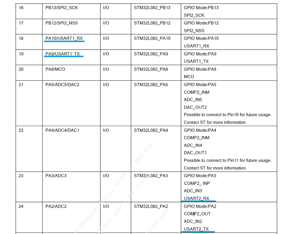

I use 'PRINTF' and 'AT command' using vcom.c from the I-CUBE-LRWAN source.
And develop in the following situations.
1. UART communication uses RS-232.
2. I use  STM32L082 low-power chip.
3.I use LPUART and NVIC interrupts.
and then, I made the following changes and tested them.
1.change uart port. (usart2 - > usart1)
2.in usart1 port i uses RS-485.
Then PRINTF and AT-command do not work.
Do you have to add other parts to the following sources when using rs-485? Or can you use usart1 as the uart port of lpuart? (See terminal configuration)

void vcom_IoInit(void)
  GPIO_InitTypeDef GPIO_InitStruct;
  /* UART TX GPIO pin configuration  */
  GPIO_InitStruct.Mode      = GPIO_MODE_AF_PP;
  GPIO_InitStruct.Pull      = GPIO_NOPULL;
  GPIO_InitStruct.Speed     = GPIO_SPEED_FREQ_MEDIUM;
  GPIO_InitStruct.Alternate = UARTX_TX_AF;
  HW_GPIO_Init(GPIOA, GPIO_PIN_9/*this point change*/, &GPIO_InitStruct);
  /* UART RX GPIO pin configuration  */
  GPIO_InitStruct.Alternate = UARTX_RX_AF;
  HW_GPIO_Init(GPIOA, GPIO_PIN_10/*this point change*/, &GPIO_InitStruct);
