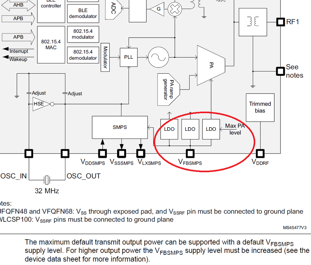

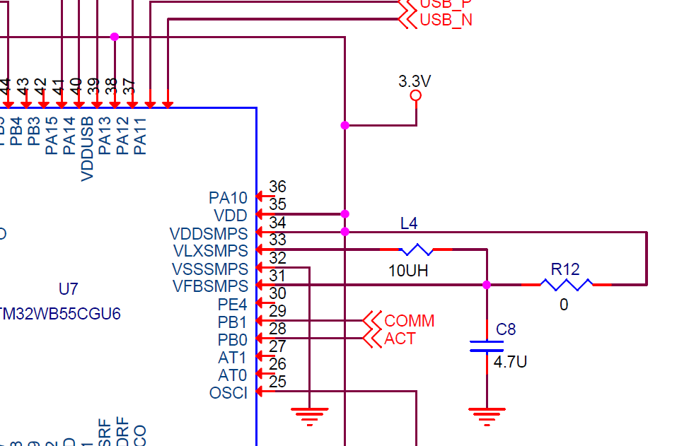

According to schematic, my board is as above that follows ST reference schematic.
VFBSMPS is fed by 3.3V. And VDD is as well.
To increase Tx power, I think I need to do 'Max PA level' in the red circle below.
To do that, I try to find the proper API as below.
LL_PWR_SMPS_SetStartupCurrent()
LL_PWR_SMPS_SetOutputVoltageLevel()
ZbNwkIfSetTxPower()
Can you tell me what to do to increase Tx power which help coverage much more like 40~50m?
If you can tell me how to make a coverage much more like 80~100m, I really appreciate your help.
Thanks in advance.
