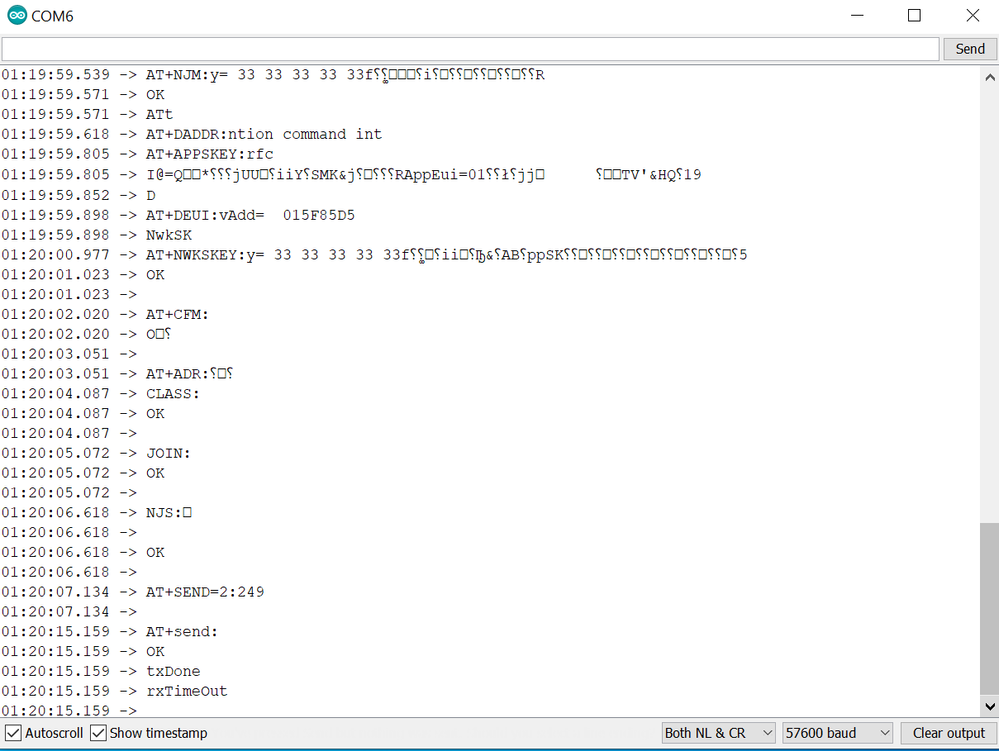

I'm Using stm32 based Lora Module in India Interface with Arduino by AT CMD Set
MAbde.2
we are not Getting non readable value from module also it's not sending to gateway but same cmd working with dock light0690X00000ByaxDQAR.png

>>I'm Using stm32 based Lora Module...
Not sure that's terribly specific. Does it have a part number, perhaps a website?
Does it have a manual?
If you connect it more directly to a terminal, can you walk it through the command sequence successfully with that?
