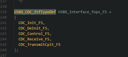

I have problem with USB stack as Virtual Port COM to use it with sequencer prepared to BLE stack. I mean I don't know how to execute needed CDC... functions inside usbd_cdc_if.c. Did anybod do that?
I want to send via UART and via BLE received through USB VCP.
Any Application Notes to do that?

Hi @dnj
USBD_CDC_ItfTypeDef defines the interface for CDC class on firmware. Each of the functions corresponds to a callback that should be called during operation. As far as I know, to implement a CDC VCP with sequencer, is like implementing it in as task in an OS. The following example does not use an OS:
STM32CubeWB/Projects/P-NUCLEO-WB55.Nucleo/Applications/USB_Device/CDC_Standalone at master · STMicroelectronics/STM32CubeWB (github.com)
I hope this would be helpful
