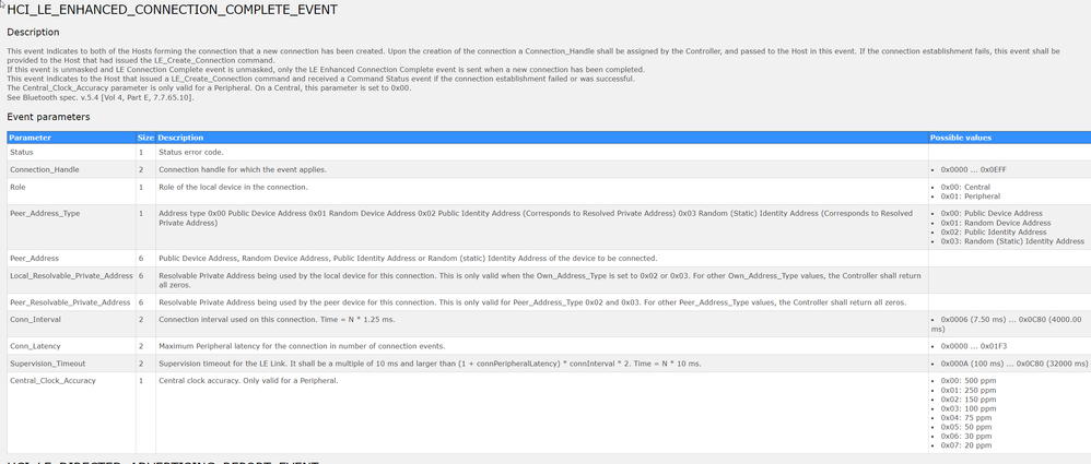

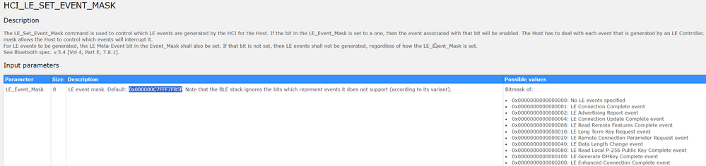

I think I see what you want to achieve. I'd suggest taking a look here https://wiki.st.com/stm32mcu/wiki/Connectivity:STM32WB-WBA_BLE_Privacy#First_example-_connection_between_a_smartphone_and_a_STM32WB-WBA.
You might succeed by using the event HCI_LE_ENHANCED_CONNECTION_COMPLETE_EVENT.
If you already have the device bonded, this should provide both the resolvable address and the resolved one (if you have the bonding info stored, of course). To register this event, you can put this e.g. at the end of BLE init
hci_set_le_event_mask(0xC7FFF7F85F | 0x200);
